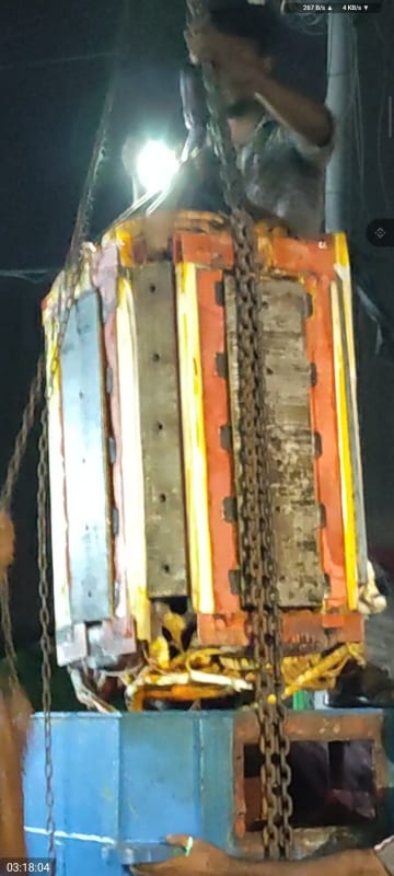

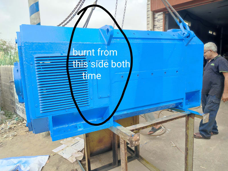

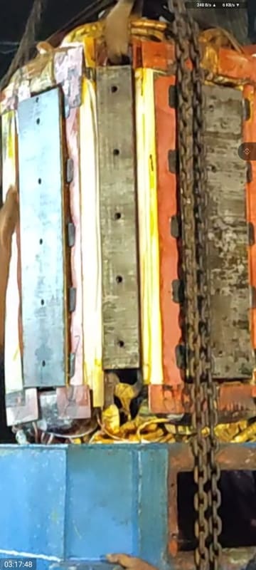

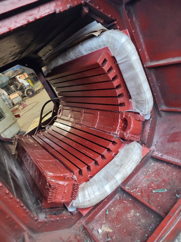

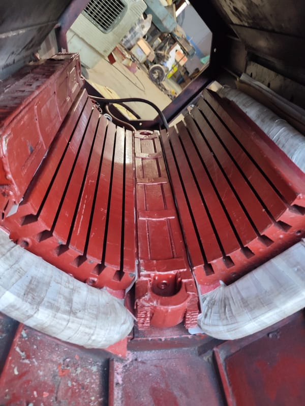

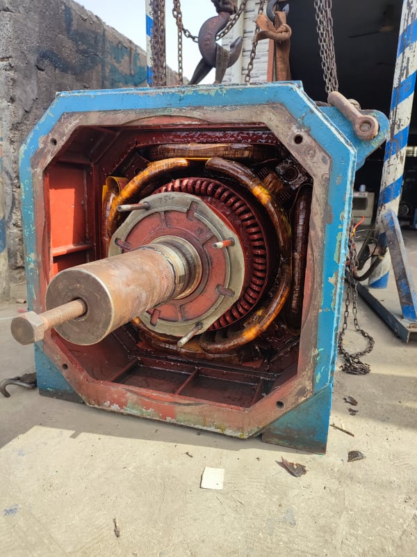

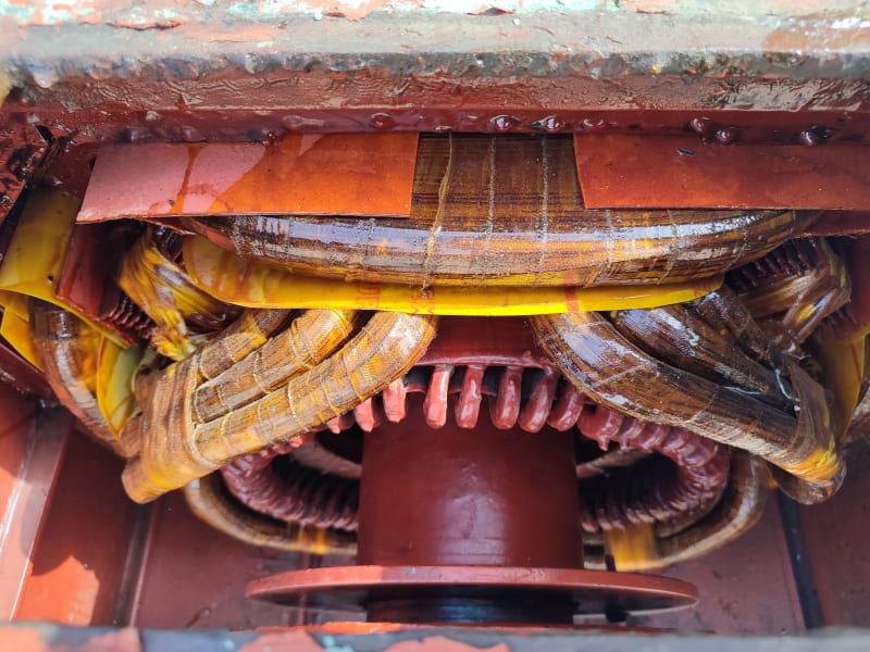

Hi, i need help i rewind motor field winding but the issue is all 4 fields burnt after some time but only half side of the field the other half of the field was as good as new recheck connection all are correct field voltage as per nape plate is 180 volts with 23.5 amp when the motor runs on DC drive field voltage keep increasing minutes after minutes but Ampere remains same. Drive is working fine i have checked it,

Ok, field turns and connection are ok since you got the base RPM of 500 at 23.5 A.
Normally, the field voltage starts at about 70 to 80% of rated voltage in the cold start and as the field winding warms up and thermally stabilizes, you hit about 100% rated voltage to compensate the winding resistance rise due to temperature rise.
In your odd case, you keep going beyond rated 180 V to 280 V to hold the field current at 23.5 A. The only reason I could think of at this point is that the copper you used is not electrolytic grade 99.9% pure copper but a commercial grade copper (probably made from scrap copper with its impurities) and its resistance is high to begin with and went into thermal runaway that overheated it.
Do you have original vs rewound field winding DC resistances measured at room temperature for comparison?
I have seen OEM's cutting corners and the machines ending up in my shop with burnt field windings within a short period of commissioning. But in those cases, field current was not stable (due to ever increasing turn shorts) and hence the speed was not stable. Yours seem very odd with a stable current and stable speed.

Tell me one more thing if i add one more blower on commutator side or change the original blower to commutator side will it impact good or bad?

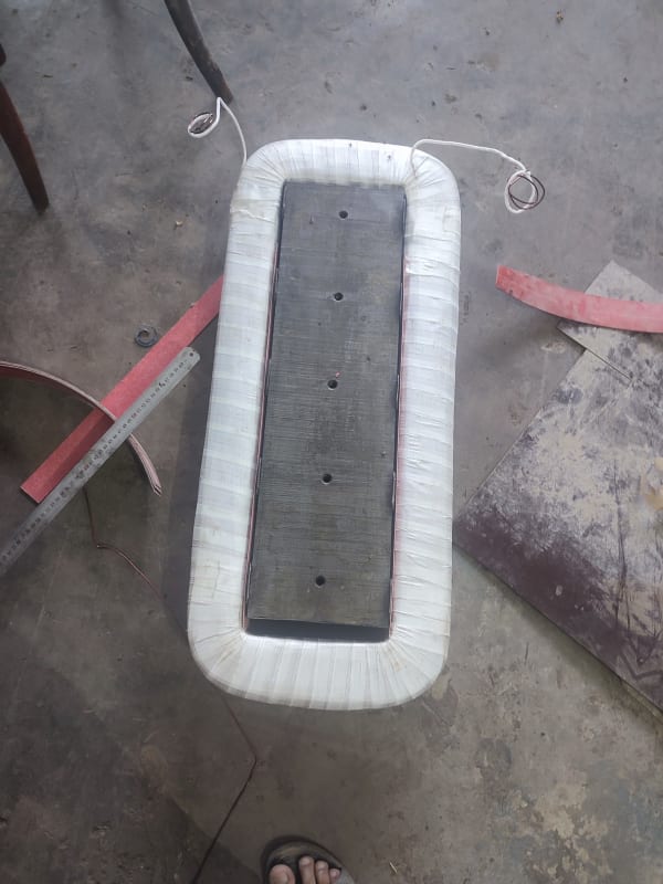

Kflan if there is any slight changes in wire guage the weight wouldn't be same as original weight is exactly same as original and when motor was original it shows 7 ohm on when motor is not running and 7.7 after hot

So, resistance variation was 10% for original winding that mean for copper a delta temperature about 25 degree and new one have 180/23.5=7.66ohm cold to 280/23.5=11.91ohm... 55.5% variation that mean 141 degree if copper ideed is used... but seem to be "other copper type".
You need to be more forthcoming with old and your new winding resistances in order for us to help. Otherwise, you are wasting other people's time.
I doubt the original cold & hot resistances are 7 and 7.7 ohms. Going by the nameplate, cold & hot resistances (both original and rewind) should be around 5.6 ohms at 30 deg C and 7.7 ohms at 90 deg C (as per standards).

Your field winding turns and connections are right if the motor turns at rated 500 RPM at rated field current of 23.5 A and at rated armature voltage of 440 V.
Wire suppliers make all sorts of spurious claims, trust me.
Comparing OEM and your winding resistances at room temperature is the straight forward way of comparing the quality of your wire (provided you didn't change the wire size).
If OEM's and yours are about 7 ohms at room temp, then OEM screwed up and you can't be blamed for temperature rise since their original cooling system/design and/or field winding design was not good enough to begin with and you just copied their design.
But if OEM resistance is 5.6 ohms and yours is 7 ohms, then you need to admit your wire is of poor conductivity and hence poor quality and you need to take it up with your seller.

Neither i change the wire size nor turns, as per user's statement they took field resistance in winter around 20°C it was 6.6OHM IN ORIGINAL WINDING rest you know
If i rewind this motor should i increase its guage? From 14 to 13 and make it 5.6 OHM at 30°C?
