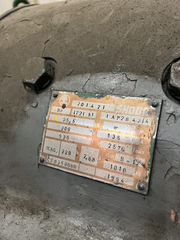

If anyone has any insight, advice, places to look or inspect, it would be highly valued and greatly appreciated. I do not have access to the PLC programming software, as the previous electrical engineer here had passed away and his family had taken his personal computers which had the program on it. The PLC is an Allen Bradley PLC5/15. I have attached the label for the 50 H.P. DC motor and a video of the flashover event when stopping the spindle.
