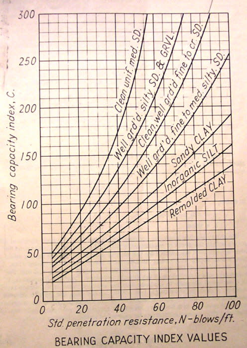

The paper deals with uniform sands, at least some of which are similar to standard Ottawa sand as used for various laboratory tests. There is a paper by B.K. Hough "Compressibility as the Basis for Soil Bearing Value", August 1959, ASCE SM 4, 2135. He also has some of this info in his Text: "Basic Soil Mechanics". In his charts he shows the difference in support capability, on the basis of potential for footing settlement of some typical soils, varying from uniform sands to clays. Specifically he shows that for the same N value of SPT the uniform sands have better bearing capability than well graded sands. In my experience that is true. Some discussion contributors to his paper verify his chart is quite valid for sands. I liken the differences to the difference in supporting (compression) capability between a bucket of marbles to that of well grade gravel.
In summary, I'd expect that maybe the DCP might work the same as STP for these different sands.
