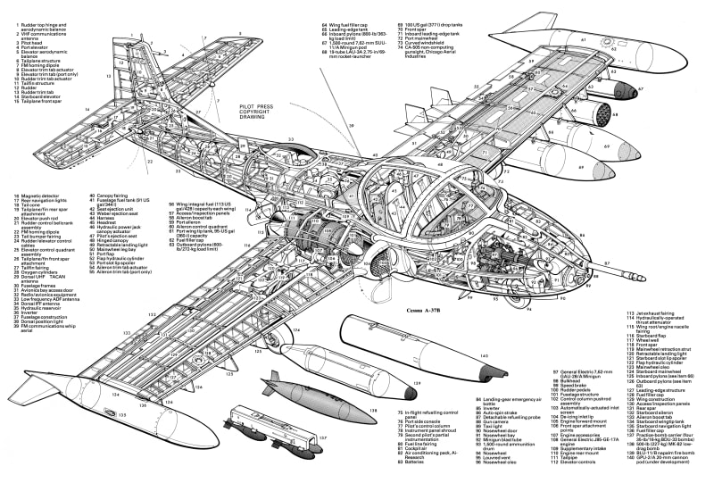

T-37 'Tweety Bird' is a classis examples of light MIL-Jet with engines between wing spars where the inlet and exhaust passed thru the spars. It was quit successful @ ~7500# GTW.
Straight wings.
[2] J-69 Engines between spars.
MLG between spars, inboard bays adjacent to engines
Fuel cells in all the 'other' wings cavities... and between the engines in the fuselage [main tank]
Crew just forward of the front spar.
Light weight sheet metal cockpit/nose and aft fuselage sections with the stabilizers...
Classic examples of 'span-loading' design as taught is Aero Design 101.
When the T-37 was called to go to war... IE modified to be killing machine A-37s Dragonfly...
The [2] engines were replaced with J-85s [non-afterburning].
[2] 100 gallon wing tip tanks were installed along with pressure refueling/AR probe.
[4] underwing store stations were added to EACH ~10% wider-chord wing.
All fuel cells were upgraded to self-sealing; and ballistic felt-padding was added to cockpit side walls
A 7.62 mini gun was installed in the RH nose compartment and an ammo-feed drum was in the LH nose compartment.
Some comm/camera equipment was added to the aft fuselage 'hell-hole' compartment.
Ejection seats were upgraded for better survivability.
The main landing and nose gear struts and tires were beefed-up... upgraded... to accommodate the new GTW 14500#
Fuel and weapons added-up to almost ~8000# resulting in a GTW TO weight of 14000 [later increased to 14500#]
Amazing what benefits were derived by span-loading!!
NOTE the widely separated engines made for greater safety in case an engine failed and for IR-missile tracking [reduced/split heat signature].
These jets were originally intended for relatively short life of 4500-Hrs of total flight time... but with structural mods could make 7500-hrs safely
I have some structural illustrations, somewhere... I'll post a few IF I can find them.
Regards, Wil Taylor

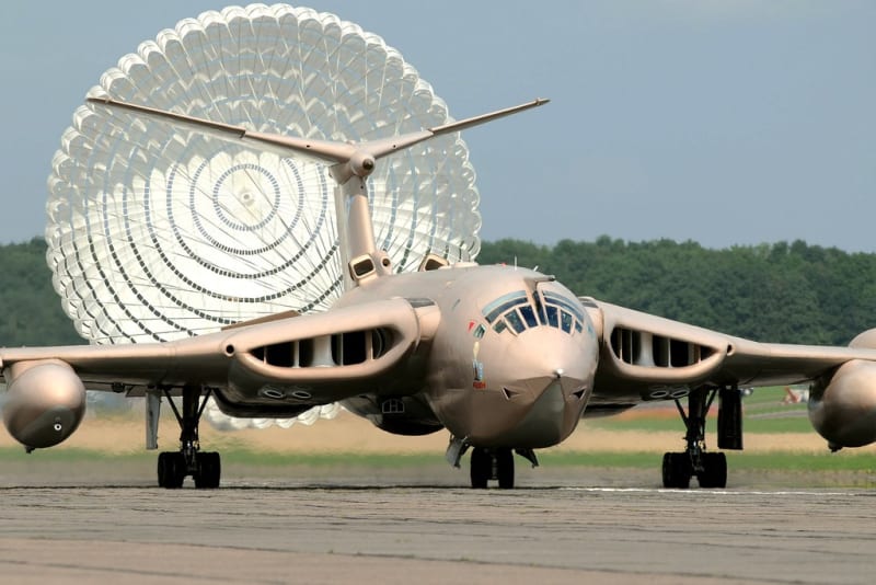

Does this count? (HP.80 Victor)

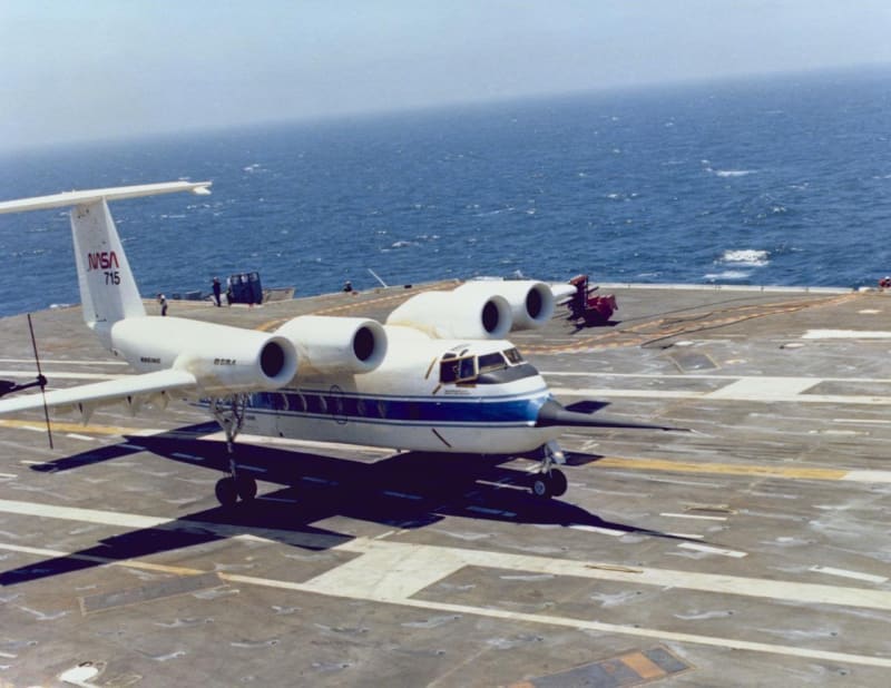

Speaking of interesting engine mount configurations (NASA QRSA)...

A-37B Cutaways...

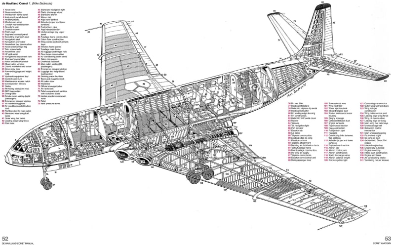

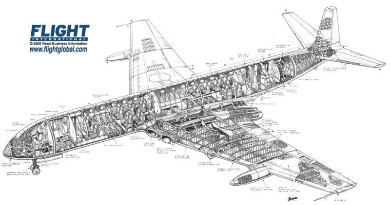

Comet 1 and 4 cutaways... for grins....
Comet 1 most were permanently grounded [not economical to mod/repair]... square widows
Comet 4 [used extensively for commercial and military service]... rounded/ellipse windows...
Regards, Wil Taylor

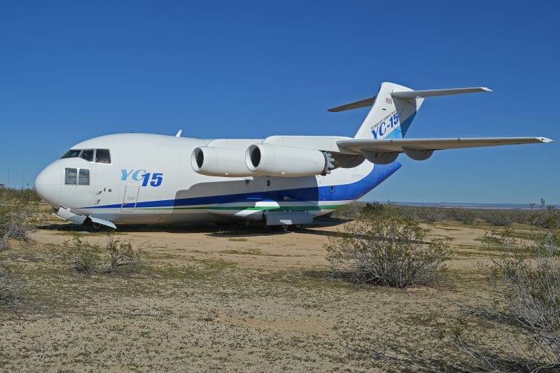

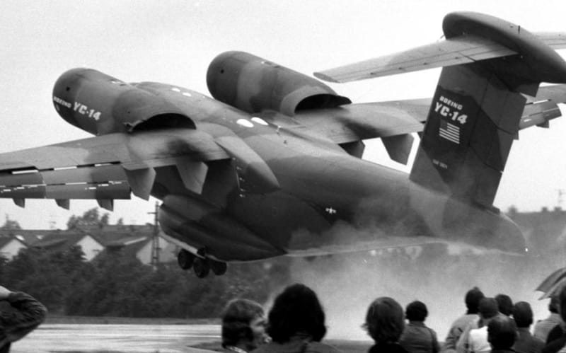

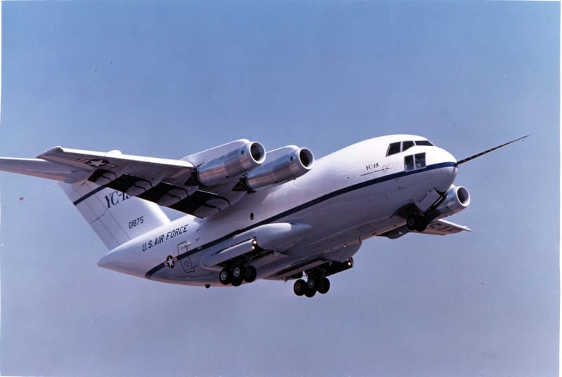

and for giggles... YC-14 and YC-15 prototypes
Boeing YC-14... radical STOL configuration...
VS the more conventional MAC-DAC YC-15... Mini C-17 wanna-be...
