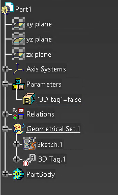

Hi all;
from F1 CATIA documentation:
"A 3D tag is a geometrical feature with all feature capabilities and is used to display text in the geometry.
3D tag is a geometrical feature with all feature capabilities such as activate, deactivate, delete, reorder, isolate, undo, redo etc."
However, when I explore the tag in a rule language browser, it tells me it is of a Feature Type, not GeometricFeature Type, i.e it has no activate/deactivate property...
Right click - deactivate works of course, but how'd I do it within a KWA rule?...
regards,
LWolf
I don't have the KWA license but I was able to link its activity to a boolean parameter. Maybe that works for your needs?
well, what I am actually trying to do is to activate/deactivate a whole geo-set...
let L(List)
let myGeoSetSINGLE(OpenBodyFeature)
let myGeoSetDUAL(OpenBodyFeature)
let myItem(GeometricFeature)
let I(Integer)
set myGeoSetSINGLE=SINGLE
set myGeoSetDUAL=DUAL
if TYPE =="SINGLE"
L=myGeoSetSINGLE.Children
For myItem inside L
myItem.Activity =True​
L=myGeoSetDUAL.Children
For myItem inside L
myItem.Activity =False​
it works well if all my shapes are of type geometricfeature, but unfortunately 3Dtag is of type feature...
despite what it says in the documentation!
