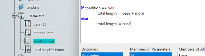

you could try something like this:
if ( Width Offset Needed` =="RH" or `Width Offset Needed` =="LH")
`Total Angle Length` = `Angle Length` +`Width Offset Length`
else
works for me
