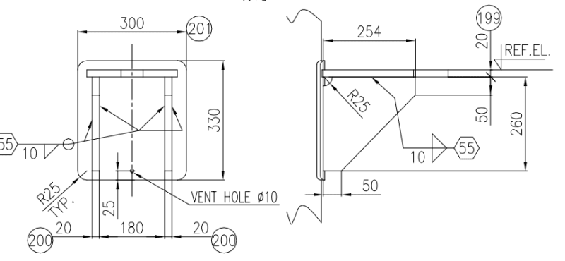

a)ribs = vertical gussets
b)Please see PIP standard support FEFV1114 and you can see proportions of the parts. Your pad is very small and the gussets very short in height
c)I insist: Investigate the cause.
d)what is the shell thickness? and the thickness of pad, gussets, top bar and base plate of the support?
Regards

Thanks for your input. The shell is SS304L 10mm. External Forces and Moments for each support is. Support pad dwg is as below.
Radial Load (SUS) P 10000.0 N
Longitudinal Shear (SUS) Vl 52500.0 N
Circumferential Shear (SUS) Vc 10000.0 N
Circumferential Moment (SUS) Mc 1800.0 N-m
Longitudinal Moment (SUS) Ml 9450.0 N-m
Torsional Moment (SUS) Mt 1800.0 N-m

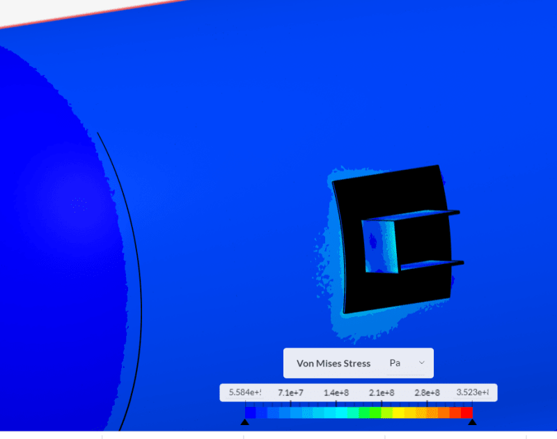

I initially ran a FEA model with original pad size. The von Mises' stress was in excess of yield point. So I ran another with 500x500 pad with finer mesh. The stresses in the area of interest was about 140 MPa, lower than yield of about 172 MPa but higher than Sec-VIII-1 allowable stress of about 115 MPa.
So the suggestion is:
1. As @Geoff13 pointed out please review the loads and try to bring down the load (or eliminate it) by arranging for supports from deaerator floor level.
2. If that is not possible increase the pad size to more than 500x500 mm and try to use Sec VIII-2 with DBA(design by analysis with FEA) for qualification of the PV. PVElite is also an option.
Disclaimer: I shall not be held responsible if the FEA result is used without further verification.
