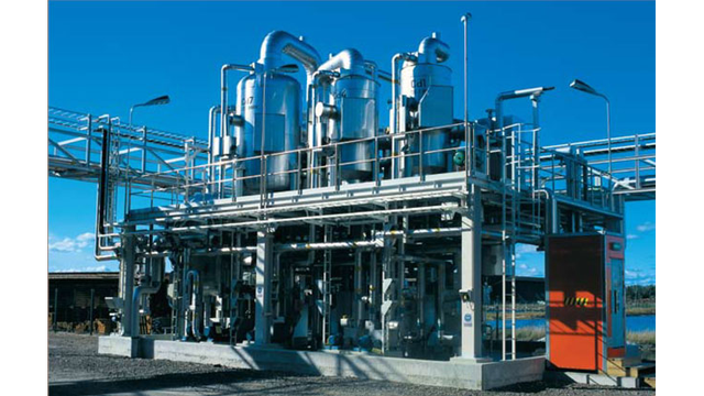

There is a detailed discussion on this topic in Perry Chem Engg Handbook, chapter on heat transfer equipment , subsection on Evaporators.
Another resource:
You may want to contact them, both GEA and Alfa Laval
Pierre
