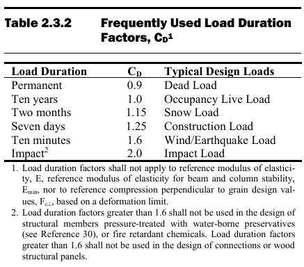

That brings up second question, can you consider a railing force as a temporary load and use 1.25.
This is really the bigger question. Most engineers seem to use CD=1.6 for deck posts. Some use 1.0, and apparently others (like yourself) use 1.25. I don't know the correct answer on this, but it's been debated a lot here. If you don't use CD=1.6, I can say you'll have a difficult time getting the connection to work. FWIW, most of the deck holddown connectors on the market assume CD=1.6 in their published load capacities (although I'm not sure there's much justification for that). If you're confident that the railing would only be subjected to the design load for a total duration of 10 minutes over the course of it's life, then the table shown above allows you to use CD=1.6.
Is it really total duration and not individual durations? If so, 2 months of snow does not seem realistic.
1.6 isn't allowed, it's a LIVE load. This is illogical (maybe), but oh well.
Also, if you are dealing with DFL (incised) to me that suggests you're out west, and out west, they sometimes like to use "green" lumber in construction. That will affect CM, as well. (the M is a capitol). Yes, I know that's being overly picky, but there it is.
I would also point out that CD = 1.6 is "maxed out" in the argument, there's nowhere to go above that. That's fine in holdown calculations for tension elements and the like, but when it comes to a guardrail I'm not a fan anyway, even if it could be justified with a literal read of the code, which it can't.
On the 1.6 duration "from fastener manufacturers", I think that's for a "misuse" of the product, not what it's intended for, particularly if we are talking about a Simpson DTT which is for securing the deck laterally to the house, not for a guardrail connection which it is not, to my knowledge, tested for. You can use stuff "off label" but you have to make adjustments as needed if the duration of load is wrong, i.e. if I use hurricane ties for collar tie connections but the duration of load has to be adjusted you can't use the "stock" value without adjustment.
XR250 - yep, total duration. It's 2 months of design snow load over the course of a building's life. It's all about time at maximum loading.
A guardrail may not see 10 years worth of 200lb point loads, but 10 seconds isn't very practical, either.
Wow - learned something today - I had always thought the load durations were the length of time during incidence - not total cumulative.
Ignoring the statistical tweaks, it's hard to imagine during a structures' lifetime that you will hit the 50 year 3 second gust 200 times (10 minutes = 600 secs / 3 sec per gust)?
Crazy

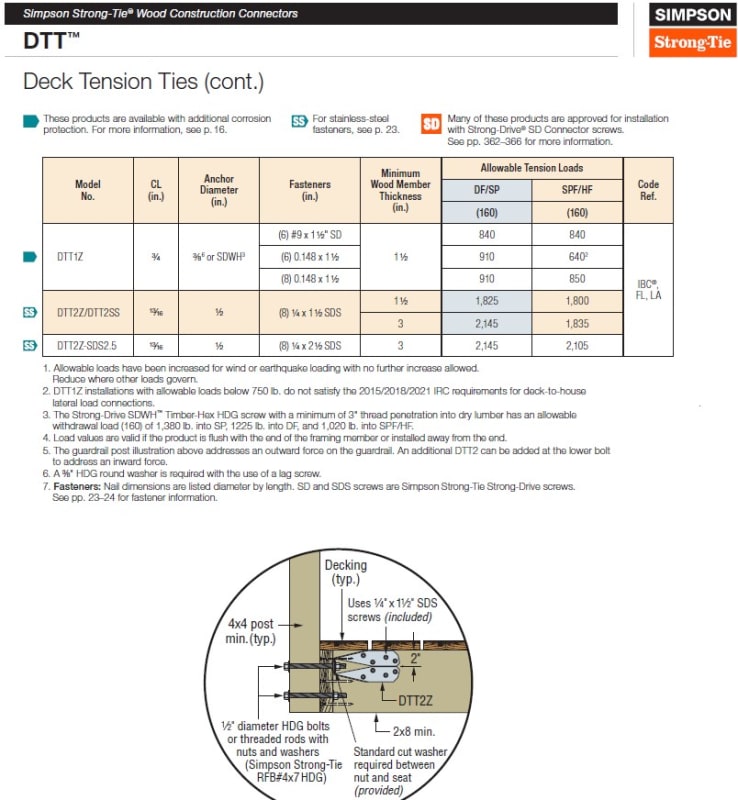

The Simpson DTT is intended to be used to secure a deck railing post. Below is p. 315 from the 2024 catalog. Under "Allowable Tension Loads" notice below it the load duration factor "(160)". I don't necessarily agree with using this load duration factor either, but this is what they use. If you use 1.0 or 1.25 instead, now you're stuck with reducing the load that the connector can take (not that most engineers would even be aware of that, I imagine).

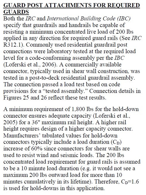

Eng16080 - If I recall correctly the original DTT was intended to secure the deck through the exterior wall, (that requirement appeared circa 2009?) and to me that makes sense as CD = 1.6 given the origin of those loads (wind/seismic, as there wasn't research on live lateral loads (from occupants) until later on). I think the DTT2 they expanded the use, (maybe?, partly in response to the Woeste research pointing out the typical "nail and forget" approach wasn't strong enough) and the ESR covers that use. You can factor it down on the presumption that the listed (tested) load is not connection limited and comes directly from testing (said adjustment would be conservative if it is "fastener limited", as I recall, I usually check in with Simpson Technical support to confirm that approach is valid and haven't exactly specified one on a deck - I usually note the code requirement and say "contractor provide connection per IRC XXX.X" at ends of deck).
Lateral Loads Generated by Occupants on Exterior Decks, Parsons, Bender, Dolan, Woeste, Structure Magazine, January 2014.
(I'll NOT reference the FAQ from here...that's a direct link to the 2014 article, which is kind of reprint from a Wood Design Focus article as I recall).
ETA - Well, that timeline of events isn't perhaps supported "in the record" as the guardrail article was 2005.
Strong Rail-Post Connections for Wooden Decks, by Joseph Loferski and Frank Woeste, P.E., with Dustin Albright and Ricky Caudill, Journal of Light Construction, Feb 2005.
I don't have a date for when the 1,500 lb connector appeared in the IRC. Maybe someone else feels like tracking that down, I think it wasl also revised downward on the load requirement at some point.

If I recall correctly the original DTT was intended to secure the deck through the exterior wall, (that requirement appeared circa 2009?) and to me that makes sense as CD = 1.6 given the origin of those loads (wind/seismic, as there wasn't research on live lateral loads (from occupants) until later on). I think the DTT2 they expanded the use...
Yup, I think this checks out in terms of using the same connector for a new purpose.
From "Prescriptive Residential Wood Deck Construction Guide - Commentary":
