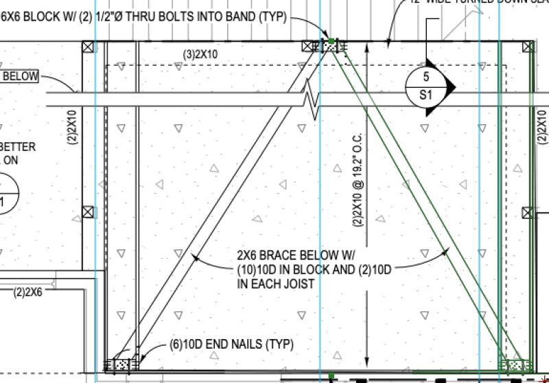

So, what do you typically do now when you design a deck? How much lateral load do you use? Do you calculate the tension chord force at the end of the deck and use a tension hold down device like IRC Figure R507.2? According to NDS, the allowable shear capacity of a deck with horizontal decking member is only 70 plf. I have a deck with really tall columns (20 ft). The columns and beam will not give that much restraint laterally. I read an article somewhere about a test on the deck where people move left and right simultaneously and it generated about 12 psf of deck area laterally in the middle. That seems crazy high. Luckily the deck has a pretty good width to depth ratio (24 X 11). I just want to make sure I do this correctly since the columns are so tall. Any advice?

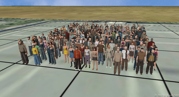

Same in Australia. 2kPa for residential balconies and decks. And only 1.5kPa if less than 1m above ground. These numbers have always seemed way too low for me.
Here's 2kPa (40psf). It's far from packed.

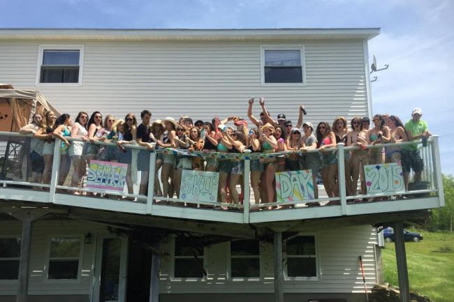

Loads of this magnitude (or higher) are fairly common in private residences, and break many a deck:
That 2nd photo would be perfect for the asce commentary.
