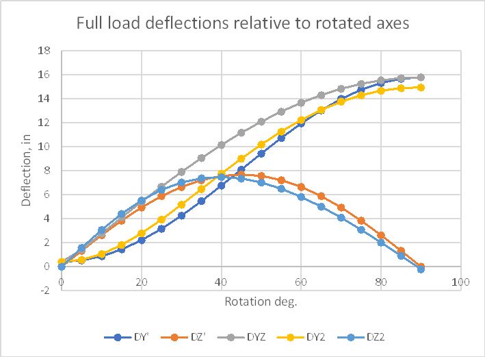

I'm a bit late on this, but I thought it would be interesting to check the results from a 3D frame analysis.
I have run two analyses using Strand7:
1) Loads were specified in the vertical and horizontal directions, and incrementally factored so that the resultant load rotated through 90 degrees in 5 degree increments. The resulting deflections were then rotated to find the resultant deflections parallel and perpendicular to the resultant applied load.
2) The load was applied in the vertical direction only and the beam was rotated in 5 degree increments; i.e the model replicated the actual loading as closely as possible. For this case 2nd degree geometric non-linearity was included.
The results were:

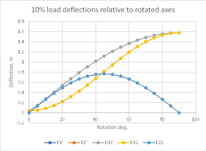

... so close, but significant differences between the two runs. This waas because geometric non-linear effects were significant, and were only included in the the second run, so I reduced the load to 10% and found:
... near exact agreement between the two runs.
In summary "Method 1" from the OP gives accurate results for the maximum resultant deflection, with the vertical deflection being a little lower.
Doug Jenkins
Interactive Design Services
IDS, Thanks for running that analysis. I would have liked to check my results against those from a frame analysis program, but don't currently have a license for one. As you mentioned, my Method 1 results appear to match your plotted results above. The "Total Deflection" and "Vertical Deflection" lines from mine look very close to the "DYZ" and "DY'/DY2" lines from yours.

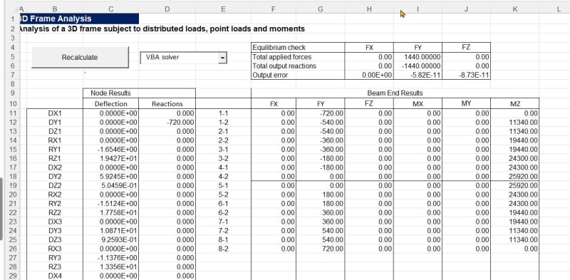

Eng16080 - There are quite a few free options for doing 3D frame analysis, including my 3DFrame spreadsheet (attached).

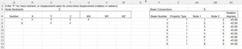

It was actually pretty easy to set up this problem in the spreadsheet because you can specify a rotation angle for any beam:
For each change of angle you need to recalculate the frame:

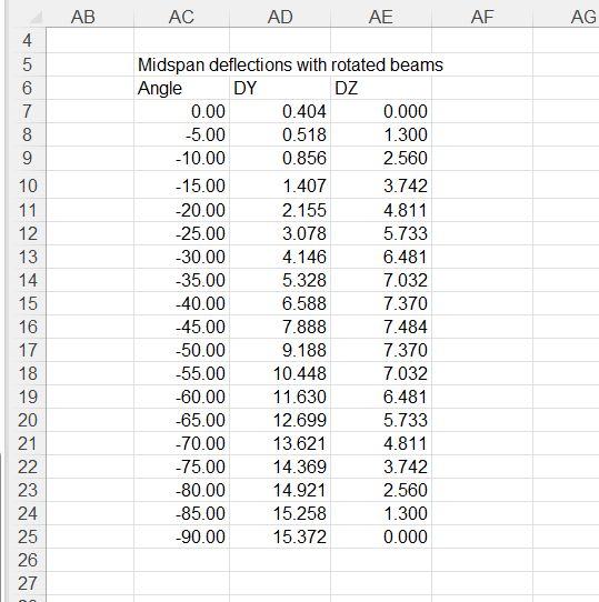

Then you can extract the midspan deflections for each angle:
The results are in near exact agreement with my Strand7 results where I rotated the loads, and didn't include non-linear geometric effects.
The download spreadsheet is set up with this model and the results summary table shown above.

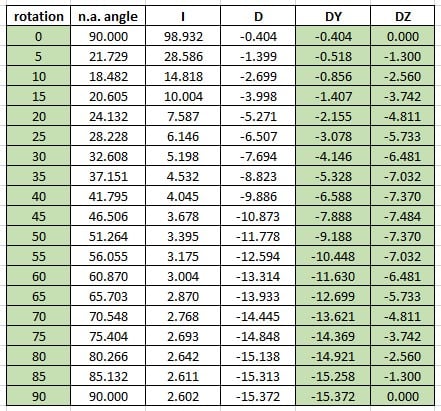

For my "simple" beam analysis tool, I was hoping to not have to resort to a 3D Frame analysis to account for the member rotation (but perhaps it's inevitable). I did derive an expression for moment of inertia which seems to give total deflection (not vertical) of the beam without needing to split up the applied loads into individual components relative to the beams local x and y axes. That expression is:
I = 1 / sqrt[sin2(alpha)/Iy2 + cos2(alpha)/Ix2]. If this leads to the total deflection (relative to the neutral axis), then if the neutral axis angle is known, the vertical deflection can be found.
I'm not fully confident this approach is correct, but it seems to work. I'll need to review mechanics of materials a bit more. It's crazy how complicated the problem becomes when the section is not perfectly vertical or horizontal.
Thanks IDS. Both the excel file and your website will be great resources going forward, especially if I get serious about completing a 3D frame analysis program. That looks like a ton of effort on your part.
The simple beam program that I'm currently working on uses the 2D (planar) stiffness method. While this obviously isn't as versatile as a 3D frame analysis, I figure it will cover about 95 percent of the member analysis that I typically do for a residential project (mostly wood framed). When/if I eventually create a 3D frame program, I'll also be able to use this to verify some of the results. I suppose I'm trying to create something similar to Woodworks or Forte.
Concerning the original problem I was having calculating the beam deflection, the method I described above works, at least for the example problem. I get identical results to those from your spreadsheet as well as Woodworks software:
