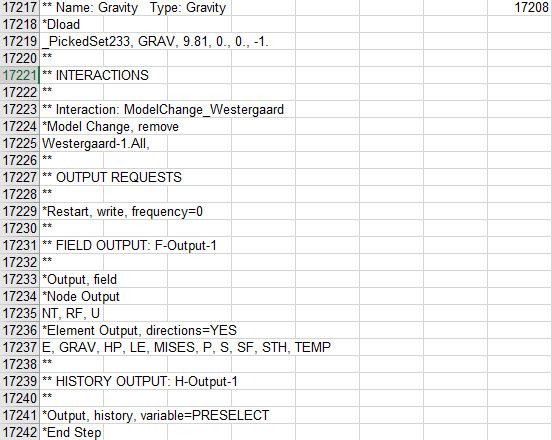

FEA way, could I ask about another error I get:
***ERROR: in keyword *CONFLICTS, file "XXX.inp", line 17208: Keyword
*Conflicts is generated by Abaqus/CAE to highlight changes made via
the Keywords Editor that conflict with changes made subsequently via
the native GUI.

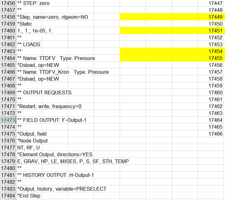

Is it possible to highlight the error they mention? I copy pasted from the .inp file and I think this is what they meant by line 17208? Not sure what error theyre referring to..
Edit: Get same error here and a few other places highlighted in the yellow line.
This error means that you added or changed some keywords using the built-in editor and then they became incompatible with what is defined in Abaqus/CAE. To eliminate this error you can simply delete the whole *Conflict lines from the keyword editor. But generally speaking, it’s better to avoid using this tool (exactly because of these issues) and instead modify the input files after exporting them from CAE.
I am working on a model someone else made, and therefore I am not sure what changes they made in the keyword editor. I tried to look for "*Conflict" but couldn't find it anywhere. Any suggestions?
Changes done in the Keyword Editor should be highlighted there when working on a .cae model. There’s also a button to remove all the changes at once.
