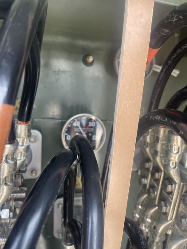

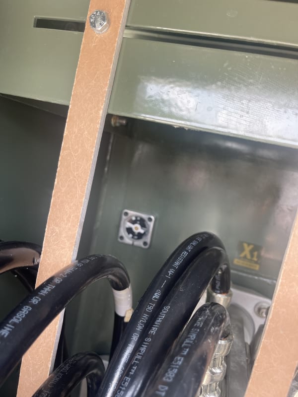

The tap dial is “marked” wrong as to indicating its place, but it in fact is set at “A” position for a 12470kva with current of 415/240.

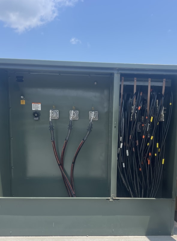

We also tested the primary wire going from top of pole to the transformer and it tested good.
Right now we are going with the theory that our units are poorly balanced and the imbalance is causing a fuse to blow.
(Also this xfrmr did not seem to have any bayonet fuses on either primary or secondary side in the xfrmr cabinet).

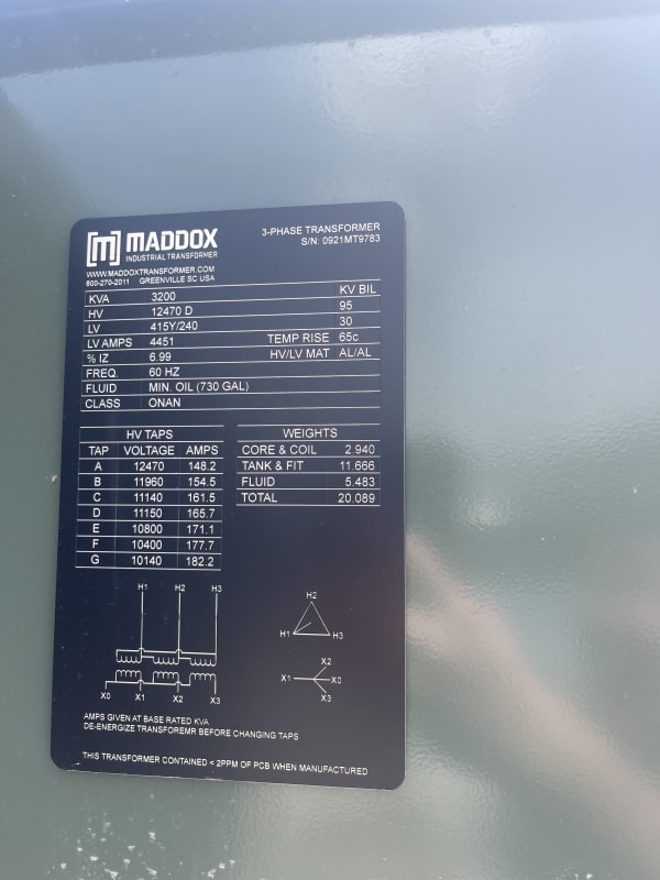

Can you post a picture of the nameplate?

Ok delta primary. That rules out a delta tertiary issue.
