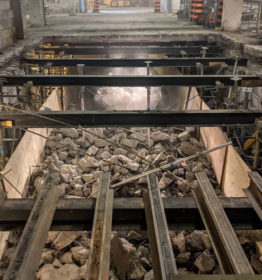

Thanks for the compliment phamENG! I used to spend the majority of my waking hours demolishing parking garage slabs and so we are right in my wheelhouse here. Got out of it because I like to see the sun every now and again. You don't mention where in the structure you are, and that will dictate a few things (e.g. at the roof deck vs second intermediate slab) but in general here is the process if you are hoe-ramming the slab (assuming it's 2-way):
Demolition Shoring (Vertical)
Usually No.2 posts shores at 5' c/c and at all leading edges. This is to ensure that the skidsteer or excavator doesn't punch through more or less. Shore debris field similarly if we are dropping onto suspended slabs below.

See the no.2 shores in the picture below? Those were in place during the hoe-ramming above and will be removed by workers before the bobcat picks up the debris. Then the slab shoring (the alumas on beams) is designed for typical slab loads only. Perhaps your situation is different so maybe you can explain the order of operations a bit more so I can better understand what's going on?

Situation is pretty similar to the one you show in the picture.
difference is shoring system, 10K, will remain in place for demolition and pour.
It will be saw cut on the edges, and then, broken into smaller pieces with a chipping hammer. There will not be no bobcats, concrete pieces will remain on the top of the shoring system, and picked up manually, no equipment or heavy equipment involved.

Aww so you're breaking onto the forms. Well, that sucks but I understand now.
What you're proposing can be done if absolutely required but never with a hoe-ram since the hoe-ram would destroy the forms to bits. When you said chipping/hammering that's what I thought you meant since that's the only way we chip large slabs. Hand chipping large areas onto a form surface is madness but if you have to, I guess you have to. I've done it for small occupied areas but it's slow as all hell and for a large area I'd sawcut the entire thing except around columns or other bar that I need to maintain.
In terms of your loading I would not add anything for dynamic loads. The hammers are A) incredibly small relative to the slab stiffness, B) the slab will still have capacity while you are demoing (assuming it's a 2-way slab) and C) the construction loading allowance of 50psf won't be fully present at the time the workers are jackhammering (who will be spaced at 6+ feet apart I imagine) that can be used to offset any incremental amount of dynamic load. Also, this is a slab we don't care about so who the bloody well cares what happens to it as long as it doesn't drop.
As a practical matter I might consider adding sleepers to the topside of your forms. This will allow the concrete to "drop" which makes it easier to break, and will reduce the number of times the hammers hit the form surface. If you have the form surface immediately under the existing your hammers will mark it every time they strike; basically it'll be ruined and you'll need to add another layer on top (or you can add a sacrificial layer to begin with that you peel off after the concrete has been demo'd).
