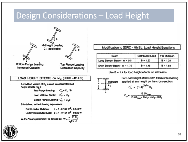

Interestingly, at today's AISC live webinar Link on the design of underhung cranes the subject of load-height was obviously discussed. The presenter, Lucas Pachal, presented the SSRC 4th Edition method and directly used calculations with the SSRC MODIFICATION, as follows:
In the SSRC-4th Edition method, the "beam parameter", W, is identical to Trahair's "torsion parameter", K, so both methods yield the same result.
If you apply the SSRC MODIFICATION method, it assumes a constant load-height factor of 1.4, disregards the type of loading (distributed or concentrated) and simply modifies the bending co-efficient, Cb, so something like this:
