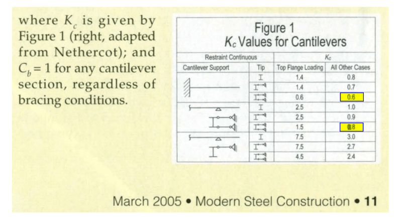

All that being said, I do have some good news for you with respect to how this thing can be designed, at least above grade. k=2.1 will be wildly conservative in my estimation.
I feel that your effective length factor can be shown to be bracketed by the two extremes highlighted below, provided that the following assumptions are true-ish:
1) With respect to buckling, we're talking about lateral torsional buckling (LTB) and only LTB.
2) The top rail cannot move laterally, along its longitudinal axis, without dragging the pile tops along with it.
3) The tops of the piles cannot rotate about their longitudinal axes without engaging the top rail in bending.
4) You check a version of tandem LTB buckling, akin to bridge twin girder buckling, and find that to not govern as I fully expect to be the case.
5) You use Cb=1. In my opinion, both [k] and [Cb] lose their intended, physical meaning for cantilevers. As a result, you'll find folks shifting the associated impacts around between variables and the name of the game becomes making sure that you're consistent with the assumptions baked into whatever method you decide to employ.
Given the complexities of your situation, and the likely importance of economy with it, you might consider using something like Mastan to do an elastic buckling analysis of the frame. It's free and fairly easy to use as far as software with that capability goes. It's a good deal clunkier than just building a frame in RISA etc. We can certainly help you with that exercise if you decide to undertake it.

Here's an old paper on length to fixity. This method has been in the appendices of a few codes of practice.
The cantilever LTB capacity KootK posted is foreign to me (EDIT: Looks like it's BS 5950's rules). Does Cb=1.0 in all cases mean the capacity is not dependent on the loading arrangement? UDL is surely more favourable than tip load because the bending moment is small except very close to the support/restraint. And doesn't it become a standard beam calculation when restrained at both ends like the cases KootK highlighted? Australian code Cb factors below for comparison (called alpha_m = moment modification factor).

No, it's just a simplified approximation. Nethercot assumed K=1 always and put everything into his version of Cb. AISC just rearranged the algebra to make the presentation more consistent with how they typically handle things. K and Cb both lose their rigorous definition for cantilever treatments which do not explicitly consider the backspan situation. And that is the case with the AISC methodology. As such, there's probably little to be gained by getting too fussy about which bucket we put our bullshit in.
It does. Most of what is troublesome about cantilevers is a result of the lateral cantilevering of the flanges, not the longitudinal cantilevering of the member. Where the flanges have lateral restraint at both the tip and the back span, I would support the use of either method and suspect that the outcomes would be comparable.
I meant the design capacity becomes independent of the shape of the moment diagram. I'll try to be more careful with words. And I forgot that AISC doesn't have an effective length calculation for LTB (correct me if not the case).
So it seems that one method has a design capacity that varies with restraint conditions while the other varies with load conditions. Taking one bucket or the other rather than pouring into one?

Sort of. It's not that no consideration is given to the shape of the moment diagram in AISC's adaptation of Nethercot's work but, rather, that an assumption is made about the shape of the moment diagram that is felt to be valid for a broad range of practical conditions. But, yes, in AISC's application of Nethercot's approach the shape of the moment diagram is a constant rather than a variable.
