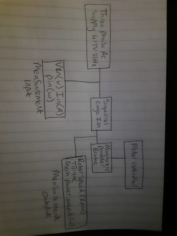

+Design of a Three phase squirrel induction motor connected to a mechanical load system diagram

I was just curious how far off I am with my current design from making my desired design. I want to produce a Three phase squirrel cage induction motor but I cant say I'm 100% confident on how to do so, currently I just want to run the design with default parameters before I start to change the values of the friction coefficient, rated stator voltage, number of poles and the rated frequency. The design is a small section of what I need to do compared to the testing although I dont have a clue how to fully make the system into a three phase squirrel induction motor as it seems I cant find anything similar anywhere. Just to add I am using PLECS 4.4.4 software.
I'm not sure if I can help, but... what are you are trying to accomplish (what will you do with the model).
Also perhaps try running some simple test cases to see how your model does compared to how you think it should do.
(2B)+(2B)' ?
This part of your drawing is the three phase induction motor.

@waross So I should be able to just add a three phase squirrel cage induction motor instead of a three phase motor and I should be good to go? I wish I had more experience with PLECS but its a new piece of software for me that I am still trying to get used to. Assuming PLECS have a squirrel cage motor although I couldn't find one previously.
@electricpete Im mainly hoping to get to grips with the system and see how it runs, first with default parameters then ill be changing the number of poles, stator voltage, frequency etc to see what changes.
OK, Got it. You are working with a software program and not trying to build an actual motor.
It seems as if you may be trying to design from scratch a complete variable frequency drive system.

The electronic portion of your drawing is normally combined into one device called a Variable Frequency Drive.
Search this forum for a lot of information on VFDs.

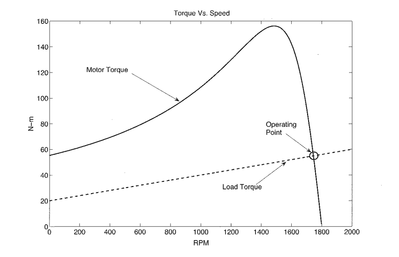

Torque curves.
There are many published torque curves for several designs of standard induction motors.
Almost all of the curves that you will find are for Direct On Line starting.
When using VFDs, the motor is operated in the last 100 RPM of the curves.
That is from the peak of the torque curve to100% speed.
The difference between the synchronous speed and the actual speed is called the slip-speed.
The difference between the applied frequency and the frequency corresponding to the actual frequency is called the slip-frequency.
The slip frequency is the frequency that the rotor sees.
Start with a typical torque curve that is labeled across the bottom in motor RPM. eg: (0-1800 RPM)
reverse the numbers so that 1800 RPM is at the left and 0 RPM is at full speed.
This is now your slip RPM.
This may now be used with good accuracy for any applied frequency.
If the slip speed is 40 RPM, the slip speed at full torque will be 40 RPM slip at any applied frequency within reason.

A typical speed torque curve. While not stated, this motor is probably rated at 7.5 HP.
It will deliver 200% to 250% if it is allowed to but it will overheat.
Prolonged operation above the rated HP may lead to motor burn-out.
A VFD is intended to operate a motor in this portion of the curve.

Appreciate the informative reply @waross still unsure whether @s do work in replies. Also, I don't think I have given a proper insight as to what I am doing/want to produce, I'm basically wanting to design a three phase squirrel cage inductor motor which I currently have set up in PLECS as just the three phase squirrel cage inductor block, which id then want to be connected to a mechanical load system diagram. So the main problem I have been having is with the mechanical load system side and how to go about designing it and with all the different systems already made out there it can be a little confusing for a beginner, as I know the background theory related to the induction motor which ill add an image of what ill be comparing to, and what I am working with, but not so much experience on how I would connect things together.
Back onto the project, the system I plan to use wouldn't need an inverter drive to be added. I feel like I am overcomplicating the design for myself like the above example, when I need the key components, inputs and outputs of the system. Then from there I would just be keeping the default values that PLECS 4.4.4 has provided, doing a simulation and taking notes of the results, then just changing one value at a time, stator voltage at 220V, rated frequency at 60Hz, number of poles, lets say 6 poles, along with changing the friction of coefficient to 0.5 then taking note of each result and how it changes the system. For me its a good way to get an understanding of what does what and how each section affects the system if that makes sense.
Id basically want to be able to include simulations for the load value changes, stator voltage frequency changes, and then calculate the synchronous speed and the slip speed of the machine which is also in my theory when it comes to calculators like the slip speed is s = ns - nr rpm or shown as a percentage, ns - nr / ns x100%. I will still be attempting to create the design using PLECS 4.4.4 and ill hopefully be able to send updates when I make progress.

Edit: Funnily enough we have a similar theory image, hadn't seen your message prior to sending my own, the theory side of it is understandable for me but I have a pain with practical sides unless im hands on with something

Ok so on further research I have come up with a new diagram but one I have not produced on PLECS just yet, the fun part will be finding all the block diagrams for what I need as ive never used the software haha. But basically I am going to have my three phase ac supply connecting to the stator windings of my squirrel cage induction motor, in between the motor and supply I want to have my measurement devices reading the input values, this will be the usual power, voltage and current readings. I will then connect the squirrel cage motor up to a magnetic powder break which basically just slows down the motor using the powder inside combined with the increase of current on the magnetic field, for this I have connected a motor controller, and finally having an output measurement connected measuring the Torque, Rotor speed in rpm and the mechanical power output. SO compared to my previous diagram that I posted this is a lot simpler. The supply and induction motors are basically blocks, so the squirrel cage motor comes with the 3 connections for the supply and a further output for the brake, the motors parameters are there to be changed inside the programme PLECS. So that side of things is simple enough and only the values I want to change need to be changed such as the frequency, voltage, coefficient and number of poles. The magnetic brake I'm not exactly sure what to do with at the moment as I cant find a block for that. The input measurements I can do using the normal meters, which should be similar with the outputs.
