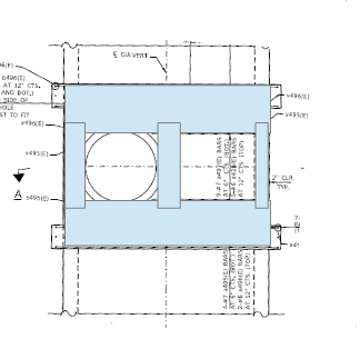

I am designing a top slab for a junction chamber. The junction chamber consists of connecting 2 ends of a 10 feet wide x 4 feet high concrete box culvert.
As part of this design, the top slab has an opening for a 4 foot diameter manhole. The top slab is 1'-1" thick. The manhole is ~10 feet high and weights 8,900 lbs. Apart from the manhole, the slab will be supporting 10 feet of soil (unit weight 120 pcf).
How can I design the top slab? What assumptions do I need to make?

Place physical beams around the opening, or strengthen the slab locally as embedded beams around the opening. Is this junction box under roadway? What is the maximum water table elevation? Surcharge?
The junction chamber interior dimensions should be in the range of 12ft length X 12 ft width and the manhole opening should be located at corner or near to side wall .
That is, it is not necessary to consider the opening for the analysis. The common practice, provide reinforcement at four sides of the opening . Calculate the reinforcement area which clashed with the opening and distribute to four sides.
You can use moment coefficients for the design of slabs and side walls.
Can you post a sketch of the problem?

I have posted a sketch below.
OK, I understand. Yes, I designed the slab like a normal two way slab - and the reinforcement that is getting cut out/removed has been redistributed around the opening thru diagonal bars.

I would design embedded beams, as shown in the sketch below, with minimum /required stirrups.
But we could not see the redistributed rebars..

I agree with dik (Structural) . You should provide reinforcement at the embedded beam shown with red lines .
I have shown the redistributed bars in the attached PDF.
This is not a typical junction chamber. The main purposed is to attach the riser section on top of it. So in the middle of a run of precast culvert, I have a small 8' section of the cast in place chamber to carry the manhole riser.

OK, I can provide an embedded beam as an option here.
How can I check that the slab has enough shear/punching shear capacity for the riser section? The wall of the riser is 5" thick, and it total weight is ~8,000# (1.6 k/ft.)
AASHTO LRFD 5.14.5.3 has a section for this, but I dont know if it applies for a slab with an opening.
Can I just design a 12" strip like a cantilever beam with point load at the end and check if the rebar is good enough?
