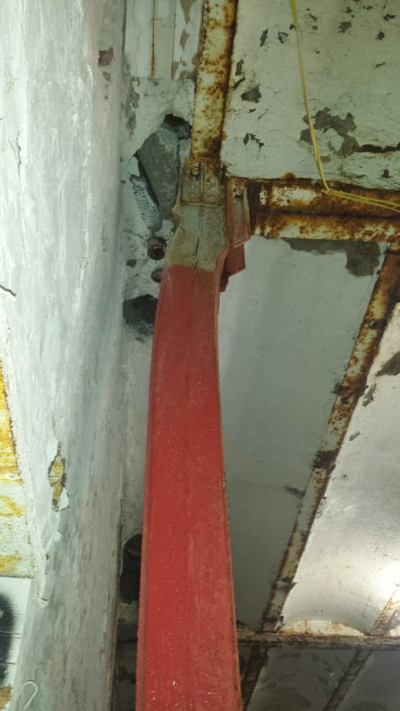

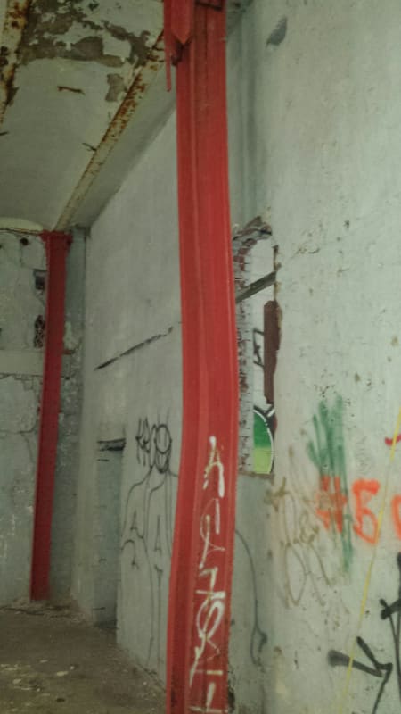

It's not clear to me what you mean by local buckling at the top. Do you have a photo?
These are some failing ones. I want to be able to put that eccentricity into numbers and analyze the rivet connection and the bending failure in the steel. The floor below that one is similar. I want to know how to analyze the failure so I can analyze the other columns in this building if they were also free standing. Interested in getting that eccentricity accurately into the column, get a deflected shape, then analyze the load on the deflected shape.
