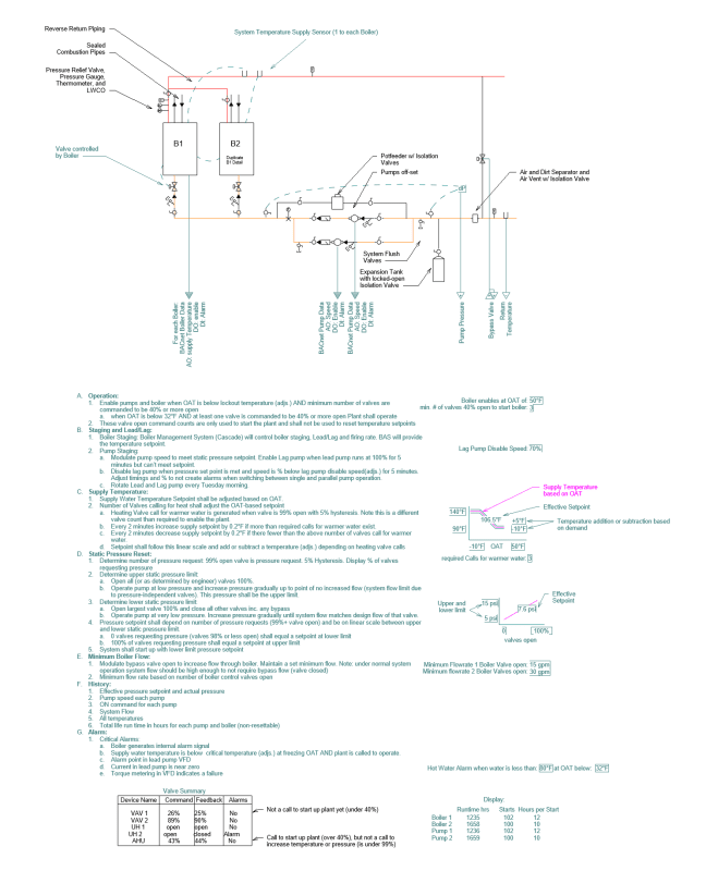

See attached boiler plant control sequence with Static pressure reset (under D). See all below for valve summary. Note we also use actuator feedback to verify actual valve position.

Could you please upload a better quality picture of the boiler that you sent before.[thanks]

@energyprofeesional-the image you posted is not clear. could you please upload its pdf

I don't know how a controls contractor programs that. But I worked out my sequence with the contractor we use all the time and he also stated the newer controllers have the static pressure reset built in, so it isn't like they have to program that from scratch. We use Niagara based controls, which most major brands use. So talk to whoever does your controls on how and what they can do with your hardware.
Older controllers may not be bale to do that easily, or at all. but that would be very old at this point.
