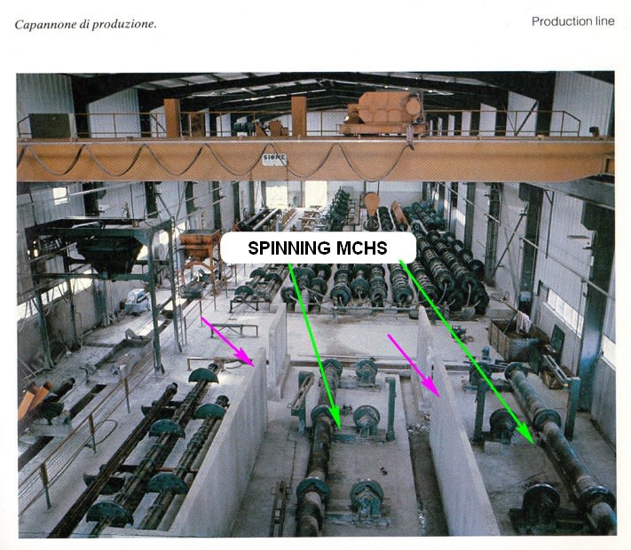

Are there standard equations to determine the distance to keep away from a rotating drum? I have a metal drum that is rotating at a somewhat high RPM. I assume there'd be some calculation on if a piece of this drum, or a fastener on this drum, were to release at the max RPM, what would its trajectory look like. Would this be the proper approach?
For vertical axis rotation
vx=Rω
vy=-gt[sup]2[/sup]/2
(Till it hits something.)

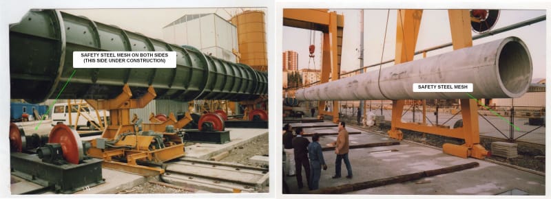

Spinning (horizontal) is typical production system for concrete pressure pipes, concrete poles for electricity distribution and street lighting, giant concrete piles (marine wharf) : protection is done by RC walls (if in production factory) or steel mesh (if in temporary production site). RPM is usually suitable to reach a centrifugal force of 15-20g : the loose piece is a bullet !!
