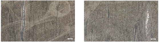

Hello,
A broken pump shaft made of 1.4021 stainless steel failed at room temperature. The broken surface looks smooth and shiny, with some sparkles when tilted. Under the microscope, the cracks mostly followed the grain boundaries (intergranular fracture), which usually points to brittle fracture. We initially thought the material might have been weakened (e.g., due to bad heat treatment). But mechanical tests don’t back this up: the impact toughness test gave 32 Joules, which is higher than the required value for this steel.
Why it’s likely not fatigue:
No classic fatigue clues like beach marks, ratchet marks, or fine striations on the surface.
Fatigue cracks usually grow through the grains (transgranular), but here the cracks followed the grain boundaries. While rare, intergranular fatigue can happen in special cases (like high heat), but this failed at normal temperatures.
The confusion:
The grain-boundary cracking suggests brittleness, but the material’s impact toughness is good. What’s going on? Please Let me know your thoughts!

Thank you for participating in this thread. Similar grade in ASTM would be ASTM A276-420. The heat treatment was QT800 (950 0C -1050 0C quenched by forced air and tempered at 650-750 0C) and was tested according to ASTM A388-11.
So why aren't you calling those curved lines beach marks?
It sure looks like fatigue to me.
Thank you for the comment. When examined under light and tilted, the fracture surface exhibits a sparkling effect. This characteristic appears uncommon for fatigue-induced failures, as such fractures occasionally display such reflective properties. Additionally, the intergranular morphology of the fracture surface further contrasts with fatigue cracks, which are more typically transgranular. That said, I value your expertise and would appreciate your thoughts on this observation. If possible, could you suggest a reference or resource that addresses this distinction? I would greatly appreciate your guidance.
There is an interesting striation at the two o’clock surface that should be investigated further. Depending on the fracture toughness (note: fracture toughness, not Charpy energy) it could be that a short fatigue crack created the conditions for a brittle fracture across the bulk of the cross section.
Thank you for participating in this thread. I assume this is the most probable scenario. I was unable to observe any striations in the SEM images. Could you please elaborate on your observation? Are you referring to the lines with the darker background in the photo (Broken Shaft.jpg) that resemble beach marks? Just want to confirm if I’m interpreting this correctly.

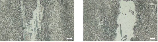

As I was initially impressed by the intergranular microstructure and shiny appearance of the fracture, I overlooked the presence of beach marks, and my interpretation was biased toward a brittle fracture mechanism. Fractography requires a trained eye and an unbiased review of the entire story. While this result is not yet final, metallographic analysis revealed localized regions of poor microstructure. Additionally, abnormal vibrations in the pump were reported. Based on these observations, the most probable scenario is as follows: Fatigue cracking likely initiated due to the imposed vibrations and propagated initially under cyclic loading. Subsequently, the crack progression transitioned to a brittle fracture mode, driven by the presence of the localized poor microstructure.

Your should pay attention to Ed's comment. There are definite beachmarks at the 2:30 position that indicate a fatigue origin. This is at the outer edge of a feature that may have once been a keyway though it may have distorted over time or from the failure.
Most of the fracture looks like fatigue. Under fatigue, ferritic steels including stainless often do not show any evidence of striations because mating surfaces contact each other while the crack grows. Macroscopically, I think I see multiple origins around the circumference of this battered surface, but they do not show up as such in an SEM. I also see a small final fracture area around the 9:00 position. This morphology indicates the shaft had a low nominal (i.e. steady state) stress and that applied cyclic stress during service likely accounted for crack initiation and growth.
Most of the fracture looks like fatigue. Under fatigue, ferritic steels including stainless often do not show any evidence of striations because mating surfaces contact each other while the crack grows. Macroscopically, I think I see multiple origins around the circumference of this battered surface, but they do not show up as such in an SEM. I also see a small final fracture area around the 9:00 position. This morphology indicates the shaft had a low nominal (i.e. steady state) stress and that applied cyclic stress during service likely accounted for crack initiation and growth under unidirectional fatigue
Thank you for participating in this discussion. You're correct—the fatigue appears to have initiated at the keyway, which acted as a stress concentrator, and this explanation seems quite reasonable. I also agree with your observation about the final fracture area near the 9:00 position, as I noticed a very small dimpled region there.
