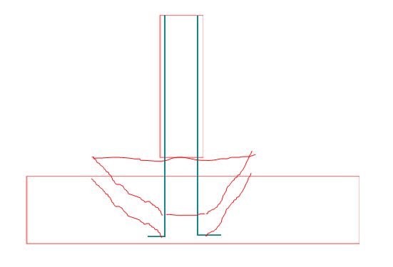

I have a concrete column which has tension in it when under seismic load. Obviously I am using the vertical reinforcement in the columns to carry all of the tension. The column is pin-connected to a pad footing at its base. The footing has a double mat of reinforcing (top and bottom) since it could be in positive or negative bending depending on the circumstance. Normally I would just hook the column reinforcing into the bottom of the footing (basically, I lap the hook with the bottom footing reinforcing). Since this column has tension in it, my question is about development length in this case. I need the column vertical steel to be fully developed because they are maxed out in their tension capacity. For the development length in the footing, do I take it as the distance from the bottom of the hook to the top of the footing? Or do I take it as the distance from the bottom of the hook to the top mat of footing reinforcing?
As an example, suppose I have a 14" thick footing, and the top and bottom mats of reinforcing are both 3" from the top/bottom of the footing. So the column vertical reinforcing is hooked (14" - 3") 11" into the footing. Am I safe to assume my development length for tension is 11"? Or do I have to take off another 3" to account for the inset of the top reinforcing as well?
I've always thought that in this case, the development length should only be 8" because the tension in the column steel needs to transfer to the footing steel, so it wouldn't start to be developed until it crosses it. But maybe I'm overthinking it. I'd appreciate other people's opinions. Thanks.

I don't think that's the case for the uplift situation. Here, I would consider the development length to extend to the top of the footing concrete.
This is an example of a situation that arises commonly here: a failure to recognize that bar development is not equivalent to bar anchorage. I believe that the failure mode shown below will be your critical check. I'd look at evaluating that as either:
1) A form of punching shear and/or;
2) An appendix D style anchorage problem.
The development starts at peak stress hence from top of the footing .
As per ACI Ldh[for hooks] depends on bar size,
Thanks for the responses. After thinking about this some more, I believe you guys are totally right. It's a question of anchorage and whether or not the concrete is going to "break out". It's interesting how ACI 318 doesn't seem to directly address break out of cast-in hooked rebar (unless I'm missing it somewhere). To be conservative, I suppose I could assume it behaves similar to a grouted straight bar, and design it based on Appendix D.
For footing design, shear reinforcement is usually not preferred, so the first step in design is to check one, and two way shear capacity of the concrete without reinforcement, with, or without moment. IMO, those checks eliminate the potential for concrete breakout, so there is no need to check it using App. D. However, since the column subjects to the moment at the base, thus the tension bars need to be developed per ACI provision regarding "development for hooked bars in tension". Then, to be classified as a standard hook with known capacity, you need to have adequate development length, LDH, measured from the yop face of tha base mat to the bottom of the hook tail, and a tail with code specified length. Missing either, the capacity of the connection is everybody's guess.

He was correct, which has been upheld/confirmed by tests and papers. I believe the reason for ACI's inaction is due largely to the practical concern has outweigh the benefit in making this change. Since failure due to the tail directing outward is not a prevalent phenomenon thus far.
