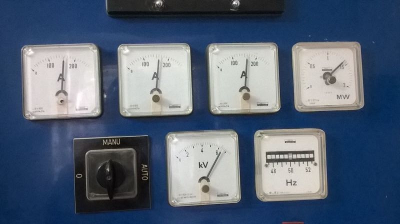

Today we have successfully test run the generator without cooling fan and with above arrangements:
Max Power: 1.46 MW
Max winding temp: 70 deg celcius
Max Driven end bearing temp: 56 deg celcius
Max Non Driven end bearing temp: 45 deg celcius
Max vibration on generator bearing = 5 mm/sec
That's nearly full load!
That was with the two fans and no ducting?
Did you confirm the temperatures actually stabilized and reached steady-state?
Keith Cress
kcress -
Yes, the test was performed without fans ducting. Actually as rightly pointed out by everyone fans without ducting were of no use. I switched off the fan after sometime, and it made nearly no impact on the temperatures.
Test was performed for about 2 hrs, and yes temperatures were stabilized. Air spargers helped alot and fans like this were of no use.
Thanks all for your continued support. We hope to get fan casted & balanced in 2 weeks time and after that it will be installed back.
