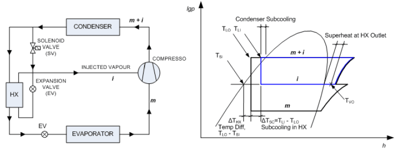

I would only consider inverter driven compressors which leaves Vapor Injection as the only major difference.
Vapor Injection (VI) or Enhanced Vapor INjection (EVI) - the same thing - allows the unit to work in heating mode down to -20C ... -25C outside air.
It also help a little bit when cooling with very high outside temps.
Efficiency is improved by 10%-15% but is more expensive due to adding additional HX and TXV.
My hunch is that VI units cost about twice the non-VI units but i don't have official feedback on this - people who know this info are surprisingly few.
May or may not be worth the cost difference, it all depends on what the ambient temps and delta T's are expected.
