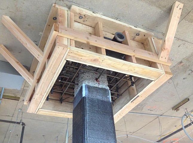

I'm making a thing: (It's no Kootware and it will probably break but it's alive!)
I'd been considering installing something drop panel-ish for the sake of restoring cover where it's been compromises. Now, I'm starting to wonder if I should deliberately create something that would be more like a real drop panel with respect to it's potential to improve shear and bearing capacity at the column.
How do we feel about this?
Yep, entirely appropriate, and been done many times before.
Form-and-pump from below.
Agree with Ingenuity. That is a viable alternative and like he said not uncommon in the least.
Just a few notes re: bearing seat
