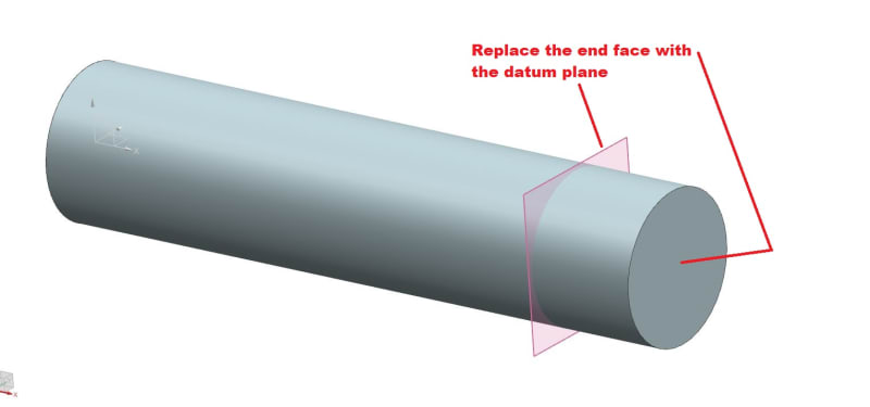

I assume this part has the same cross section for the entire part.
When cutting the part do not use TRIM, but instead use REPLACE FACE and you should be fine.
In the example below I show it "trimmed" to a datum place (parallel to the end face),
but it should work fine if you replace the end face with a planar solid, or WAVED in, face.
