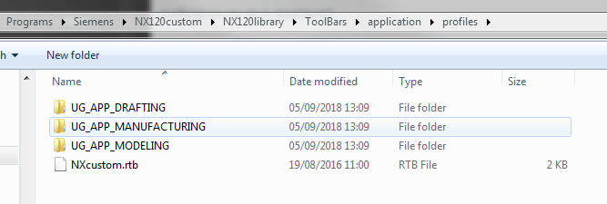

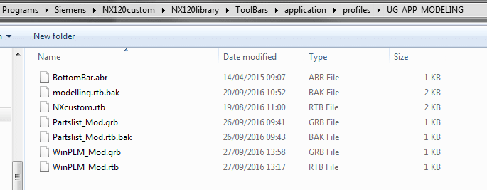

For above question,
Wherever you have placed your custom toolbars / Ribbons you create a folder "application".
In this folder you can create for each application in NX a subfolder like below.
For each application you create a toolbar showing only the buttons which apply to this application and you place them in the subfolders.
In your NX installation folder you can find such a folder structure already. You could also use this one.
NX11\UGII\menus\profiles
