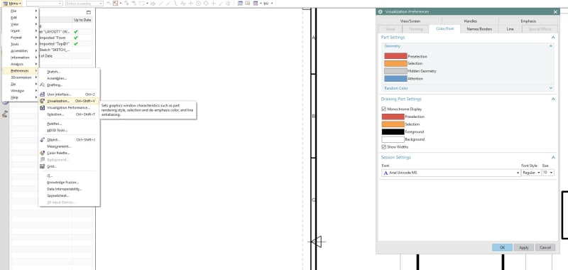

Jun 29, 2018 #1 tariq89 Mechanical Jul 3, 2013 14 0 0 OM Hello Profis, How to show the line widths in NX 10 drafting environment. When I export the drawings to PDF, the right widths will be shown, but I can't see that in NX drafting. Is there a solution for that? Thanks in advance

Jun 29, 2018 #2 NutAce Mechanical Apr 22, 2010 1,192 0 0 CH You can find that in Visualization preferences. Show Widths Ronald van den Broek Senior Application Engineer Winterthur Gas & Diesel Ltd NX9 / TC10.1.2 Building new PLM environment from Scratch using NX11 / TC11 Upvote 0 Downvote

Jul 24, 2018 Thread starter #3 tariq89 Mechanical Jul 3, 2013 14 0 0 OM Thank you for your support. It's worked, but I had to activate the line width from the color/Font as well. please see below photo: Upvote 0 Downvote
