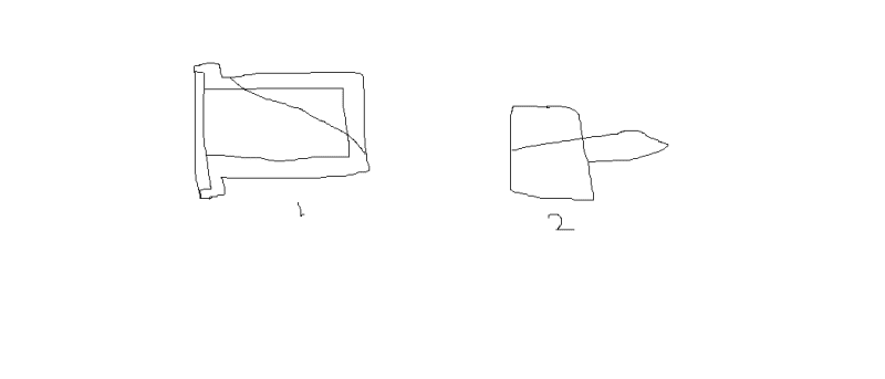

We have a closing aluminium shell. It is connected on an aluminium plate using screws and an o-ring. Inside there is a nitrogen atmosphere, overpressure, like 20mbar. We might change the shell to plastic. We have tested this, no problem.
We would like to divide the shell into two parts in order to ease the future maintenance.
What can we do to have 3 parts and be able to get them sealed? There will be a point where 3 edges join.
Here a sketch
thanks

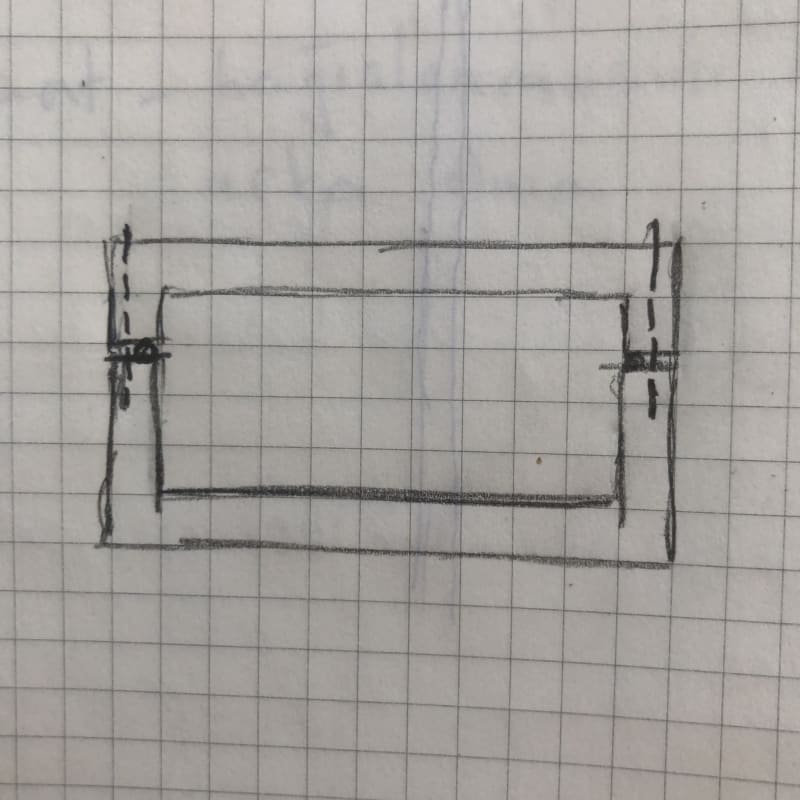

Something like this?
Regards,
Mike

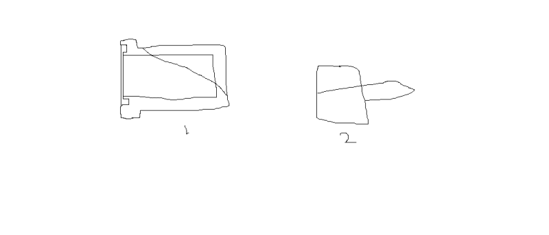

How about a diagonal split on the square box so the two sealing surface are separate? Note vastly improved O ring detail.
Or a 3d gasket (T shaped in side view) to replace the o ring and the separate seal.

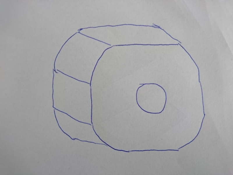

I simplified the design with our prototype geometry (and I had to draw it since I can't renew my licence because of the quarantine...). We will have a donnut like shape, with a hole in the middle where a pipe goes through. That's why we need to open it two halves on the sides.
The maintenance will be with the parts inside the shell. We want to make it "openable" to access inside.
Here is how it will look like. Maybe we could do it all round, but we need to open in half (the pipe going through doesn't allow to open it comfortably)

Why not two parts without seperate cap?
Hi Again
Instead of cutting the shell in two half's is it possible you can put cutouts on another two sides and use a oring sealed cover like you have on the front of the shell.
We need the cap. It is a light closing shell attached (with he screws and o-ring) to a stiff aluminium plate which takes all the load of the things inside the volume.
Cut-outs seem an option. But we would like to completely remove the shell to access to the things inside. There might be modules to replace, electronics...

HTURKAK drawing has a solution, however, I would have two changes. First his "O" should be in a rounded groove. Secondly, instead of his bolting arrangement, I would bolt splice plates on the sides of the two half because his bolting arrangement could cause damage to the "O"ring. The bolts for the splice plates would have only partial penetration thru the wall thickness of the two half pieces. My thoughts.
