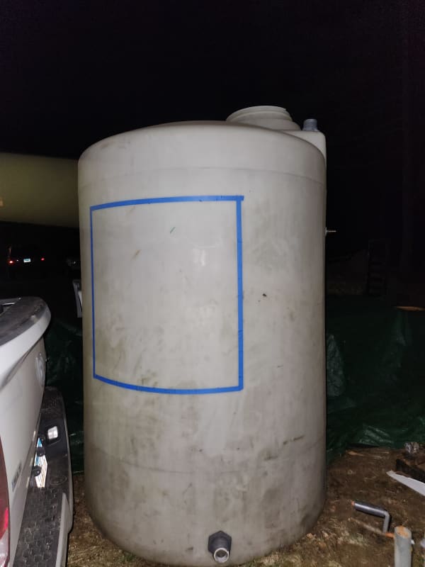

here is an image of the actual tank, the blue is an outline of a 3'x3' window. Tank is 5'-4" in diameter, and 7' tall to the dome
If i were , I would ;
- Consider 2 in ( 50 mm ) splice ..In this case Polycarbonate plate size would be ( 40 in X 40 in)
- the connection should be designed as slip critical , consider grinding (with sandpaper)) the faying surfaces to get better slip critical surfaces .
- apply polycarbonate glue . ( the glue essentially for sealing like gasket )
- drill holes and use ss fasteners together with flanges at both sides ( metal flanges square shape with interior size 3ftX3ft are necessary to prestress the faying surfaces )..
- hydrostatic test the tank for double pressure ..
my opinion

Cutting up an tank will destroy its strength at the top and cutting holes in it won't do it any good either.
This search came up with several examples. Some of these examples show stiffeners and reinforcement integral to the tank around the window.
If this tank were being treated as either an API tank or a ASME vessel, any opening the size you propose must be reinforced to ensure the load can be carried around the window. It will likely cost less to order the tank with reinforcement built in than to set up to add the reinforcement needed.

I appreciate the input, a lot of good ideas that I will incorporate; Analyzing as a slip critical connection is a good idea, roughening/cleaning the faying surfaces is a great idea as well as using appropriate epoxy. Fender washers will be a must too.
The stress concentrations at the square edge comes to mind, but to help mitigate that we can use a hole saw to round the corners so that there is not a stress concentration.
reinforcing the openings is also an idea that I had had as well. I was thinking once the hole is cut, that the edges can be reinforced with fiberglass lapped on either side of the tank.
I was anticipating reinforcing the top lip of the tank with either fiberglass and plywood (make a flange) or reinforcing that with a coping of steel or Azek.

Reinforce the top of the cut tank with rolled angle.
Cut a hole (round is best...) and bolt the window to the inside. You'll want a doubler between bolt head and window, and another one between tank wall and nut/washer. Seal with RTV on the window and tank wall, if you want to go crazy put a bead around the outside of the window (inside the tank) and fill the bolt holes prior to tightening down.
You're talking about 1 psi. This is not a pressure vessel and none of this requires hours of calculation.
Well, more like 3-4 psi, but your point is well taken, SwinnyGG. The hard part will be getting a window, be it glass or clear poly, that matches the curvature.
If you do the math it's actually 1.5 psi.
The panel needs to curved, no doubt.. but that's easy too. lay the tank on its side before cutting any holes in it or cutting the top off, and you have an exact buck for making curved poly. Heat it up, let it curve, it'll exactly match the tank radius.
'cept if you want the window to be bigger than the hole (to put the window inside the tank).
you could make a net sized window (as big as the hole) then use splices to join to the container.
