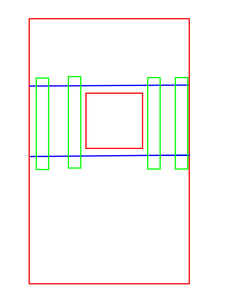

hello all, this is my first post after checking this forum for help several times. I stink at coming up with names so I am stuck with the current one... I am doing a side project for a volunteer organization I belong to and the grand scheme of things is this: We have a 1100 gallon poly water storage tank (5'-4" diameter, 7' tall) and the idea is to modify the tank to put windows in it so outsiders can observe SCUBA divers inside. See the attached sketch for the concept idea, note that the tank size has gotten much smaller.
the plan is to install 3'x3' windows at between 13" and 4' down from the top of the tank. I may have overthought this problem but the total force I have on the window would be about 1,500#, Scaling things up for a safety factor has me analyzing the windows at 5 psi (double the pressure); the resulting hoop stress for a 1/4" thick tank is 160 psi. Polycarbonate has a tensile strength of 9,500 psi, so I am not worried about that.
I was anticipating fastening the glass with 2 rows of 1/4" ss fasteners at 3" o.c. staggered and was curious to see if I could estimate the block shear strength based on the thickness of the materials. Would that even be a concern? I feel like I am overlooking something.
The material sizes and loads all seem kind of small for the application but I am also only holding back worse case scenario of 250 psf
any sort of insight is appreciated as I don't want to spill potentially 500 gallons of water
 https://files.engineering.com/getfile.aspx?folder=54f19469-416f-4a2f-be60-fc2796b219cf&file=TEST_TANK_CONCEPT_SKETCH.pdf
I would likely just try to put the window on the inside of the tank with a gasket in there, and a few fasteners to compress the seal. Then I'd see if I could put some ratcheting shipping straps around the tank. If they're a couple of inches wide you could likely put a couple over the window and figure out a way to make them look like slightly classier framing, and put one just past the window top and bottom.
You pretension them and check the capacity against the tributary ring tension, then you do a real quick check that your tank material can span between them in bending.
Cheap and dirty, not complicated math, you pretension so your load path should be fairly controlled.
You could do something less visually intrusive by running a wire ripe or other strap above and below the window and then placing periodic vertically oriented beams under them to get load to them. Load path would be shell -> vertical beam -> ring tension in wire rope/strap. Something like the sketch I'm showing, where blue is your straps and green is wood blocking or something. You just check that the tank material and the window can span between the blocking. Still pretty easy to build without fancy techniques. If it's ugly, you can get some flexible plastic sheeting and curve it around over the whole thing, then finish it nicely.
Trying to do something where your fasteners between your window and tank restore the ring tension load path seems really annoying from a practical standpoint if you don't have experience working with these materials. You're also likely going to have to troubleshoot water-tightness by switching things up a few times, so making that joint integral to load carrying will complicate that.

While I agree with SwinneyGG that in essence this will be a dunk tank, similar to a cheap Chinese made, tow behind a truck and heavily neglected carnival style dunk tank, I also have to agree the a sudden release of 500 gallons of water is bad, especially when you elevate the opening almost 4 feet above the ground with a crowd surrounding the tank. There is a reason that carnies have a reputation.
I could reinforce the platform with open diamond plate sheets to prevent bulging and deformation of the tank itself; however this is my course of action:
cut the top off, reinforce the lid with Azek and fiberglass, cut the window openings with a radius (hole saw in the corners), reinforce the window openings 4" all around with fiberglass, install the windows from the interior and fasten with adhesive AND sealant with stainless steel fasteners with fender washers.
At that point, I could always get a better understanding of how stiff it is by "pushing on it" and seeing how the deflection is effected. Also, I can always check it before final assembly by taking it to a pond, using a trash pump and filling the tank (would take approx 20 minutes). If all goes well, then routine checks of the tank will be required. I also plan on painting the tank so that will give it some UV protection as well.
