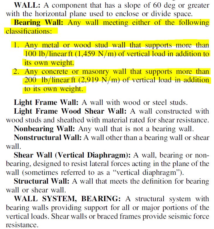

Yeah, I think we're on the same page. The crux of my issue is determining what actually counts as a bearing wall since that would trigger section 12.11.
The metal building resists out of plane wall forces with a system of pre-fab panels, horizontal girts and vertical columns. The wall panels and girts are clearly non-bearing and can be designed by Chapter 13, but the column is definitely a bearing element. So what's technically part of the "wall"? The girts and panels don't even sit on the slab as they rely on the column for both gravity and lateral support. So it's fair to say that the column is part of the wall assembly, if not directly included in the definition of a wall. Anytime the wall assembly includes load bearing elements, I would apply 12.11 to those load bearing elements and also anything farther down the load path, but that position is not clearly stated or disputed by ASCE 7.
I think ASCE 7 clearly defines what constitutes a bearing wall. See the attachment bellow.
