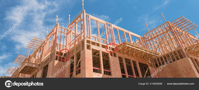

I wouldn't count on the presence of sheathing across the top plate. Say you have 9 or 10 ft walls and the sheathing is only installed up to 8'. At the same time you could have large concentrated construction loads placed on the deck such as stacks of lumber or other material.
I haven't done wood design either, so I'll let others comment on the likelihood of that occurring. But I've worked as a carpenter and I know we liked to stack as much material up on the level we were working on as we could get away with.
Here's an example of the scenario I described:
Bones206,
After completion and before loading, it will be covered by what, or will not - just leave an opening?
I’m just looking at the construction loading case. Just speculating that it could be the governing load case for the top plate while also not having the benefit of the sheathing.
