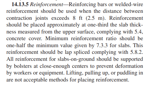

You are correct in that the structural concrete provisions do not strictly apply to slabs on grade. Obviously, slabs on grade are structural in a different sort of way.
In my experience, most of the "non-structural" slabs on grade in the wild have less than the temperature and shrinkage reinforcement. This blurb is from ACI 314 and recommends half that amount.

Agree that SOG are different beasts. But I do apply 0.2% like CSA A23.3 requires for slabs. There are plenty of ways to skin the cat, though. Given that ACI and other standards use 0.18% and 0.15%, I think there is potential that these ratios be considered acceptable depending on the load, thickness of slab, subgrade preparation, etc.
