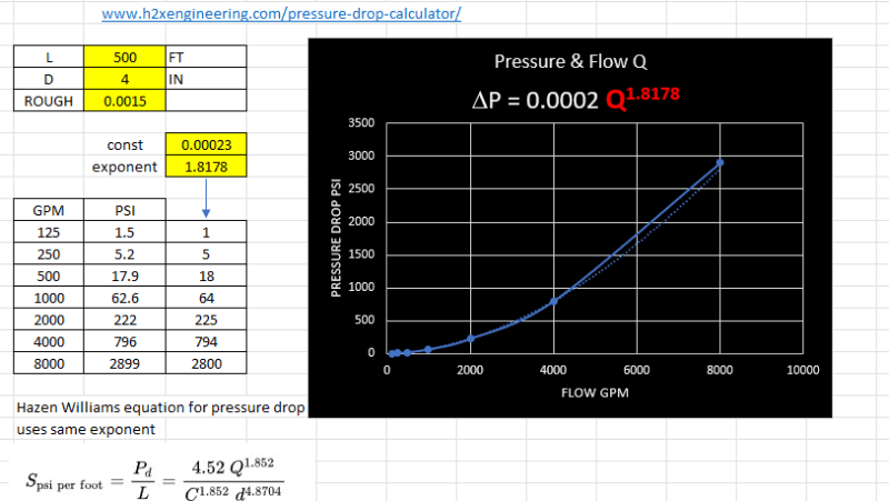

If you double the flow you would require approximately 4x the head since pressure drop is proportional to velocity squared.
In any case the system pressure drop curve does not change it just extends out to higher flowrates.

Found a better pipe flow calculator (that other one was rubbish) at Running it doubling flow rates, the exponent value is 1.8178, so required head is almost squared with flow.
Doubling the number of pumps would double the flow, but they will still be producing the same old head, so you won't get double the flow into the pipe system, unless you can increase pump RPM.
But adding the new pump doubles the original flow, which increases system resistance by almost the square. So its not working unless you almost double the head. That will require you increase pump speed by 50%, actually around 40%.
