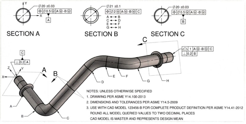

Does this use of multiple datum features make sense? 9
John-FR
Computer
Dec 16, 2020
13
This scheme was already in use. I have another person who says you cannot do this to a tube with multiple 3D bends, because it is supposed
to be used with a single axis (no bends) type of part. Could I get some input?
 https://files.engineering.com/getfile.aspx?folder=3604639e-f81e-48de-8432-99452d379b85&file=Mutliple_Datum_Features_A-B.pdf

geenimi - the problem with the two axes is that they each control 4 degrees of freedom, which is 2 two many, even in the nominally parallel degenerate case. The limited examples in the standard don't generate that sort of problem.
However, most the the examples in the standard are handouts to CMM operators. A physical fixture can be made to have the exact datum simulators per the original drawing. The CMM operators have problems doing the surface fitting required to handle odd cases like this.
In that very good example pdf, the location of "B" is highly leveraged by the length of "A". If that part were 20 feet long, then only the most perfect of perfectly formed parts would match - all others, very likely useful, would end up in the garbage.

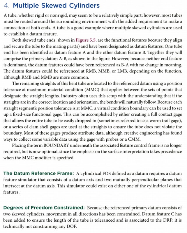

One more example for your reference, you may find out some more from SAE-J2370
(Geometric Dimensions and Tolerancing for Curved Hose)
Season
Thank you Season.
I knew I've seen the concept somewhere, in some training materails or some commerical books.
Maybe you even posted here before.
Thanks again.
Note that they skip the bends, which apparently have no tolerances. There's also the minor question of whether datum feature A and datum feature B are only at the intersection with the planes or apply to the entire surface. I'm sure there is some other detail about how there is a transition from dia 20 to dia 21 and back and what the ID/OD is where it is omitted along with the molded collars. I know - incomplete to add confusion.
I am impressed that they are expecting to hold the position of a pair of molded hose ends with 0.5 mm without restraining it.

Your example also is over constrained, unless we treat it as flexible, and call up some maximum force needed to constrain the datum[ ]B feature into its nominal position.

I would like to recommend this training book from SAE Advanced Concepts of GD&T 2009

Two skewed cylinders over-constrain movement. Datum feature C increases the overconstraint by one or two or three, depending on one's decision to count them individually or with the "ignore the ones the inspector doesn't like." Technically it implies the coordinates of the tube are measured from the datum feature simulator and that requires contact with the datum feature which may require bending the tube to fit.
ASME needs to get their stuff together and establish a surface deviation boundary which would control this explicitly rather than the additional stuff of adding and subtracting and overworking the position geometric characteristic in ways that are difficult to apply, such as in the bends.
3DDave,
Long, bent tubes are flexible. ASME Y14.5 describes how to apply datums to flexible features, and I find this feasible and practical.
JHG
I worked on a system with dozens of 20-25 foot long hydraulic lines with up to 15 bends to do tolerance analysis based on LRA data from the bender to compare to FCF specifications so I know that all too well, which is why I know these examples are so obviously poor. The examples given are not treated as flexible features. That would include limiting of the forces and specification of locations to apply them allowed to get the parts to conform to the specified limits. It's also pretty tough to manage that on CMMs.
The examples are another "tossing constraints at the problem and hoping someone else can figure it out" as I mentioned before. They look great as long as one is willing to either over specify the manufacturing process and pay more than what is required for excess precision or to toss out parts that are usable but don't happen to fit the narrow definitions.

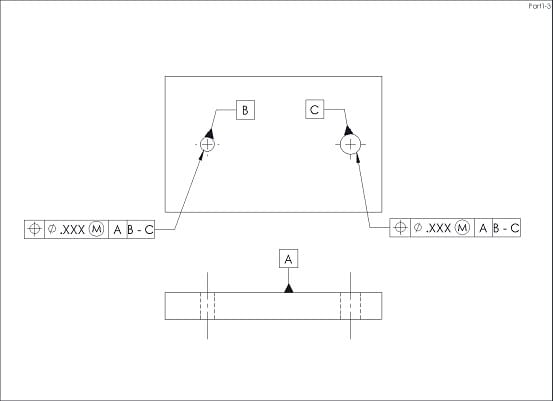

Question to the experts:
Is this legitimate control?
If no, why?
If yes, how datum / feature / simulator looks like?

I have problems with your positional tolerance call-out. A pair of round pins will define the datum[ ]B[‑]C, but either the two holes must be extremely accurate, or the two pins must be undersized and sloppy. I don't see what this is accomplishing.

Just imagine common datum features being B(M) - C(M). Couldn't do it on my CAD system. Funny, ha?
Can I get unambiguous Yes-or-No answer to simple straightforward question:
I would say, yes it is.
The same is true for B-C, B(M)-C, B-C(M)--legit controls. Not sure if functional, but you did not ask for that.
CH,
I would say that your A|B-C control is legitimate as far as Y14.5 is concerned. The B-C reference is qualitatively similar to the C-D reference in Figure 7-17 from Y14.5-2018 (or Figure 4-25 from Y14.5-2009). Both define a multiple datum feature / common datum feature using two cylinder features of unequal size, and then reference that multiple datum feature at RMB in the tolerances applied to those cylinders. There are examples of this in the runout section as well.
I'm not saying that this is a good idea, and I don't recommend it. I've always thought that these quasi self-referencing callouts were conceptually questionable, and I don't see a connection to any functional requirement. There is also the practical difficulty of how to measure the feature's axis or surface after lining up on it as a datum feature. As you said earlier, it is only necessary to control B and C relative to each other via simultaneous requirements - the B-C self-reference isn't strictly necessary.
Regarding the datum feature simulators, there are subtle practical issues here. The caption in Fig. 7-17 states that the "true geometric counterpart is the smallest pair of coaxial circumscribed cylinders". When applied to the B-C feature in your example, Y14.5's logic would mean that the datum feature simulator would be the largest pair of basically located inscribed cylinders. If we look to the text to see how to find the largest pair, here is what it states in 7.12.4 Pattern of Features of Size RMB:
"When RMB is applicable in a FCF to common datum features of size used to establish a single datum, the TGC of each feature shall be fixed in location relative to one another. The TGC's shall expand or contract simultaneously from their worst-case material boundary to their LMB until the TGC's make maximum possible contact with the extremities of the datum feature(s). When irregularities on the feature(s) may allow the part to be unstable, a single solution shall be defined to constrain the part."
There has been a lot of discussion and debate in the committees over the years regarding the exact meaning of "maximum possible contact" in this context. Specifically, the point of contention was whether or not the TGC's had to always expand/contract together, or if one TGC could keep expanding/contracting after the other TGC stopped). The last sentence in 7.12.4 is new in Y14.5-2018 and is an attempt to address this. It refers to the new "single solution" default for unstable/rocking datum features, that replaces the former default of a candidate datum set. This is another can of worms in itself, that would be better discussed in a separate thread.
Evan Janeshewski
I basically agree.
May be OK technically but more troublesome than useful from practical point of view.
The question is - where to stop. I guess every member of this forum will draw the line differently.
To me "quasi self-referencing callouts" should be limited to common axis, plane, centroid (or basically defined reference) of the pattern; that's why "twisted tube" case makes me uncomfortable.
The farther an explanation gets from mechanical gaging the worse off Y14.5 is. CH's B(M)-C(M) example is merely redundant, but once one is into whether or not some features are simultaneously expanding or contracting? I haven't yet seen one that does not require part deformation; been asking for what seems like 20 years and not one example where the mate is of unyielding construction but also exactly alters local size in conjunction with other features.
CH,
Referencing a multiple datum feature B(M) - C(M) is generally a legitimate practice, as long as long as the virtual condition boundaries are well defined. How this would play out in the context of the quasi self-referencing FCF in your example is actually an interesting question.
The TGC's (simulators) for datum features B and C would be pins, fixed at the VC sizes of B and C. These would be the same size pins as would be needed for gaging the position tolerance itself. So the A|B(M)-C(M) references would apply the same control to the features as A| only in this case. I suppose this means that specifying A|B(M)-C(M) is legitimate, but redundant.
