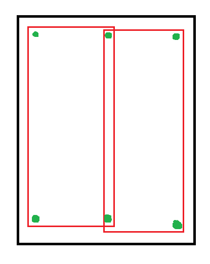

E.g. The example below, I don't think this would raise many eyebrows
Oops.
Probably 1.5 times max concrete aggregate size.
In the strictest reading of the spec, I suppose that spacing requirement could apply. It's really meant to apply where there's more than just one 2 bars, and the concrete needs to flow between the bars to get to the other side, such as in a column, where if all the spaces were that close, the concrete may not flow well into the annular space between the reinforcing cage and the outside face of the column. In this case, I don't see how 2 vertical legs of the stirrups in the middle of a beam would restrict the concrete flow in any way, no matter how close they were.

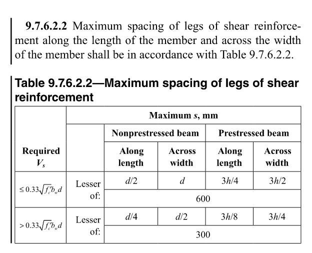

This is the stuff that ACI has to say about this.

I would not be worried about the spacing between the two legs in that arrangement (as gusmurr posted), having said that I'd never personally detail a stirrup set like that with two overlapping stirrups over one bar.
For one it is bloody hard to build in that arrangement and secondly, it's just a poorer detail compared to a single stirrup with a central link, especially for a capping beam as per OP's post which I assume is on top of some piles in a retaining wall or something like that where you'd usually have some horizontal shear as well that you'd need to resist?

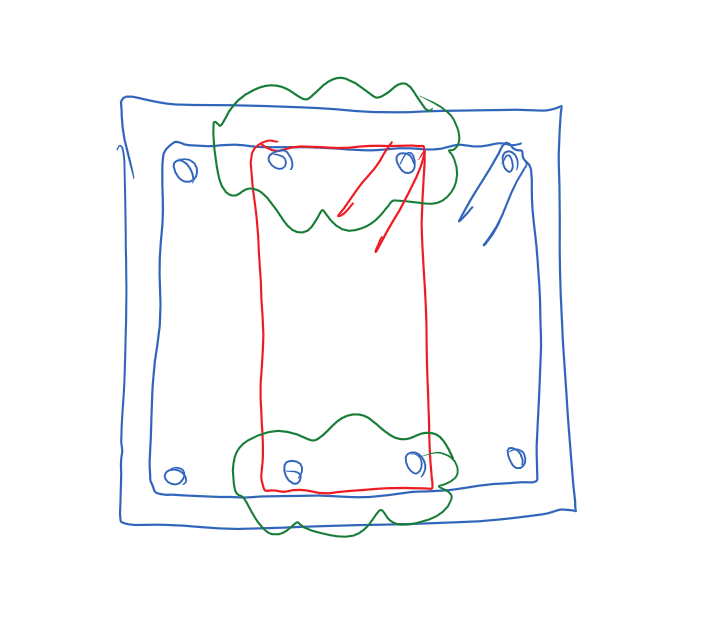

For example, we often have stirrups like those shown below in a beam and do not worry about clear spacing along the top and bottom surfaces at the green cloud between the individual stirrups where stirrups are pushed hard against one another..... does anyone worry about this... ?
For spacing of individual legs across a section follow the table from ACI Kootk posted. The NZ code which I mainly deal with has had similar provisions long before ACI added them. To some degree, you can exercise some judgement as long as an average spacing is satisfied. These spacings are required to prevent the vertical struts within a beam from becoming too shallow and causing perpendicular tension across the top or bottom face of the member causing concrete tension cracks (which your proposed arrangement would also be rubbish for resisting by the way....)
I feel that it's selve solving to a degree. The two situations in which one might attempt to exploit the inner hoop top and bottom legs would be:
1) Shear in the lateral direction and;
2) Torsion.
I would not expect most seasoned engineers to rely on anything but the outer hoops for either of those purposes.
In my mind, inner hoops are mostly only useful for additional shear resistance in the direction in which they cross the entire depth of the member.
