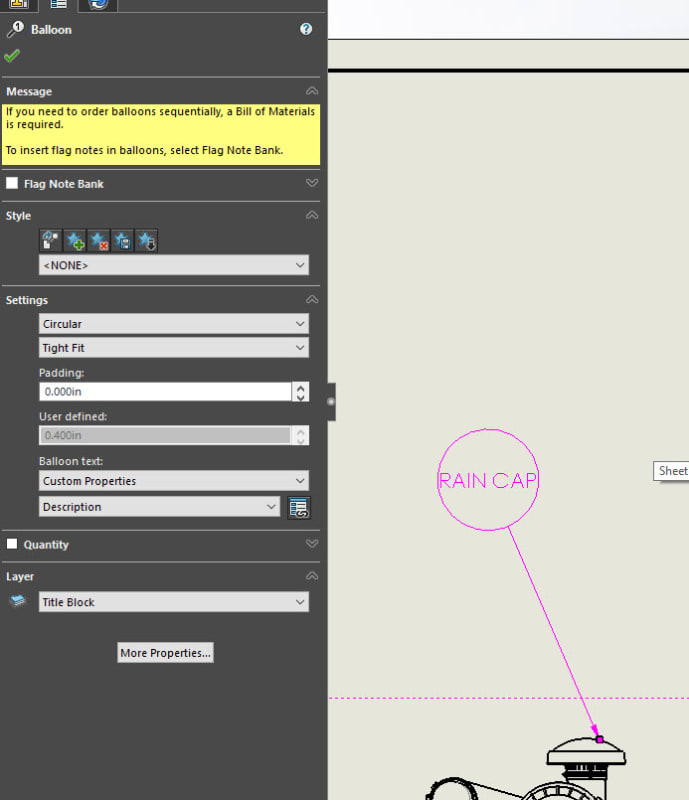

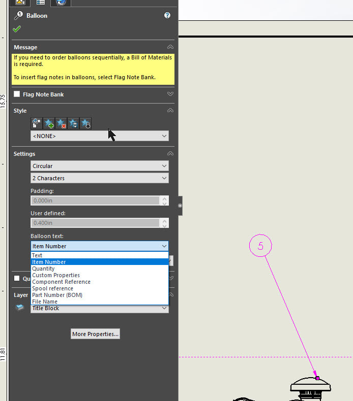

I think these images will answer your question:
BOM with a balloon:
Select the Ballon Text and pick your poison.
I selected Custom Property that is programmed directly from the part file and it pulls the same description that the BOM is pulling.
