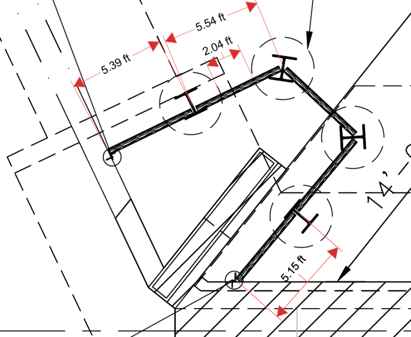

We have a job with some small and awkward drilled SPL alignments (U-shaped alignment behind bridge abutments). The short spans and shape make the drilled SPL spacing somewhat tight. The typical rule of thumb that I've seen is waiting 24 hours before drilling within 3 pile diameters of a newly installed drilled soldier pile. The contractor isn't thrilled with this idea. Just checking to see if anyone has seen anything different or approached it differently... possibly by concrete strength?

The problem is that it's a tight U-shape wall alignment. Some pile spacings are less than 8' O.C. Some drill holes are only a couple of feet away.
Sounds like the approach is to drill them and if the holes don't communicate then it's no problem. If holes communicate/collapse, start alternating drill holes.
SOE alignment was dictated to us. We can't space the piles out more to increase the clear spacing. Here's one of the systems.
Well, that layout explains why the soldier beams are so close together. I would number them consecutively from 1 to 4 and then drill and set 1 and 3 on one day with 2 and 4 the next day. How deep is the excavation?
