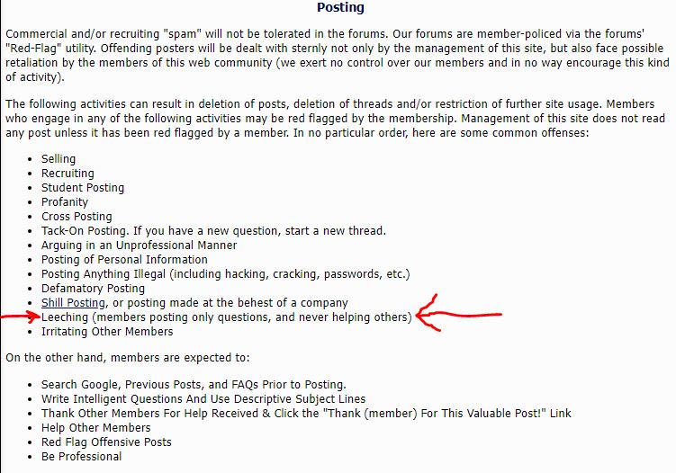

E M,
The concept of this site is that of Engineers helping Engineers.
I appreciate your posts and the questions. Always interesting of course.
But site policies strongly urge participants to also help others. Part of the bargain here.
In looking at your profile, all 29 of your replies since you've joined Eng-Tips have been in your own posted questions.
Please feel free to help others. Thanks.
Site Policies:
JAE-
I'm happy to help when I can.
I'll see what I can do.

JAE - Concerning your message to E M: I feel very strongly that there is value added to the website even when they only ask questions but never reply to posts by other engineers. By posting a question you are helping others who may have the same question now or in the future, so you undeniably helped other members indirectly. If it makes anyone angry that someone never responds to posts, they can easily ignore the post, but they may be passing up an opportunity to learn something. Just my thoughts.
says the guy who created a new account just to add 1 meaningless, off-topic reply to a thread
I don't check people's participation quota or whatever you call it. There's a group of maybe eight to ten folks who are steady contributors, I won't hold myself out as on of them, but I get a nice glowy feeling helping. Even if it's just a "me" feeling, and I'm actually of no use to anybody here. Most of the questions prompt me to dig in a little and see what "material" is out there, sometimes something useful turns up. It's funny how often that happens. I've got nobody to mentor in-house, ... sometimes the questions can be exasperating, some are more eyeroll, and then there are the little tangles with other members misconstruing or misunderstanding what you meant. It's a net positive. Perhaps, to quote John Bender, "That's social... Demented and sad... but social."
Sheesh. I thought I was very polite. :-)
