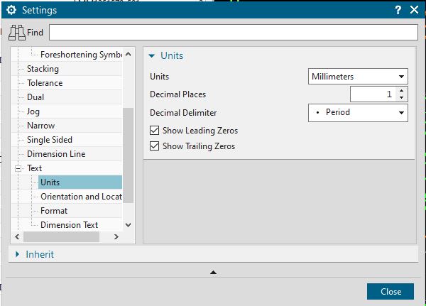

Hi All,
My company is moving towards using dual dimensioning on some products due to our products being made by both US-based companies and EU-based companies. The traditional way of dual dimensioning would be to have both dimensions (with the secondary dimension in []) on the same view on a drawing. Is there a way to show one set of dimensions on the first few sheets of a drawing and then duplicate the views with the secondary set of dimensions on later sheets?
I'm envisioning something like the manuals received by companies where the first x pages are in English, and then the next is Spanish, the next French, etc. I'd like to see if there's a way to have the first few sheets in the primary units, then the last few sheets are duplicated from the first, but showing the secondary units.
Is this possible to do without having to physically dimension the component twice and merge files?
Thanks!

Thanks all for the comments. I agree with quite a few sentiments that if you have duplicated sheets, it could be a nightmare to keep in synch. My team creates ~15,000 drawings per year and while some are simple 1-sheet drawings, there are many that are 10+ sheets of detailed views.
Going the programmatic route is probably going to be my best course to have individuals dimension the first "set" in the primary units and then use a program to copy those sheets and swap the dimensions to the secondary units.
All you need to do to swap the dimensions to different units is change the primary units in the dimension settings.
Jerry J.
