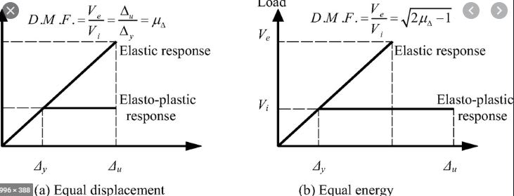

3) Because of the 4X over-design, your moment frame joints may remain elastic for more of the seismic displacement history than they otherwise would. Conversely, that means that they'll spend less time being shoved through plastic deformations than they otherwise would. And that feels a lot like less energy being dissipated. That's what's bothering you, right? Code seismic design typically follows the equal displacement principle, as shown below. While the principle is only sort of true, we deem it good enough for most purposes and it implies that, so long as a structure can withstand the imposed displacement that we think it will need to endure, we're not overly concerned with how much of that displacement is elastic vs plastic.

By material strengths, I meant the individual member capacities. You have somewhat touched on it in your 4th paragraph. I was thinking that if NZS ensured that the capacity is very close to strength, than we can ensure that hinging does occur at the load level we are designing to. I have seen people do ductile design where capacities are way greater than strength, particularly in wall only buildings where minimum reinforcement criteria governs, but as you and Kootk mentioned, we don't need to worry about this as it basically means the structure will stay elastic for a greater return period earthquake. We just need to ensure a ductile failure mechanism.
