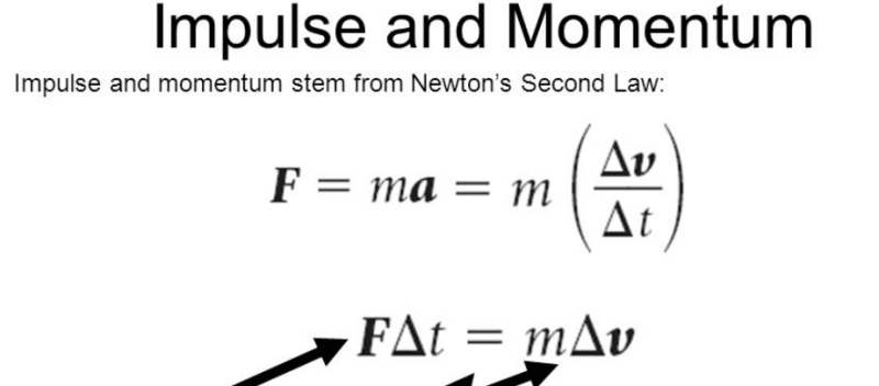

Hello,
I am analyzing a structure that it's going to be transported by road and by airplane.
Following standards we saw that normally for these transports the structure shall support at maximum 2.2g in all directions.
Hence, the structure was designed to withstand up to 3g (4g in best-case scenario) in all directions.
The thing is that now an enterprise told us that we should put stickers that detect up to 10g acceleration. They told us that this can happen when the structure is in a forklift and it passes through a hole or a bump, or in this kind of operation.
My question then is : Should I be worried about these loads ? I mean the duration is really short and, consequently, I don't think it is relevant to be considered as a potential failure.
Thank you in advance !
Cordially,
EC

human909 said:
You can't just ignore a large or reduce a force because it is transient.
It's not a matter of ignoring it. It's simply recognising that a high load acting for milliseconds is not nearly as bad as a sustained load of the same magnitude. To fail a structure you need to both exceed its static capacity AND you need to do a certain amount of work. If a load pulse contains less energy than the amount of work required to fail the structure then the structure wont fail, regardless of the peak intensity.
I completely agreed with the above statement.
However that same load pulse wouldn't achieve a 10G acceleration of the structure.* Any accelerometer on the structure in or around the COM wouldn't register 10G. Which circles back to the comments that the first few half dozen people posted.
*Unless we are talking of a load pulse that is of the time period more commonly associated with acoustic range range. Then of course you can get very high accelerations, but accelerometers and other devices that are sampling in this range would be better called microphones!

As I keep saying. An acceleration isn't a force.
If the peak load on a structure's centre of mass is 10G then I would be designing all the elements in the load path to the centre of mass to be capable of withstanding a FORCE of 10g x mass. My normal caveats apply. EG vibrations in the sonic range or above which is a different case for most 'structures'.
But this is mostly a non issue because accelerations on a "structure" of 10G is mostly not a realistic event when we are talking about structures that structural engineers design. It likely is a realistic event when I drop my new phone on a concrete pavement, and the associate forces generally result in an unpleasant outcome.

And as discussed before it is extremely loose shorthand. 10g on a structure has no meaning if you are actually referring to an extremely brief force. If the force is extremely brief eg a hammer blow, then the acceleration on the structure is far less than 10g. (local accelerations and forces might be orders of magnitude higher!)
If the force persists for a period long enough to cause an acceleration of 10g on the structure then every member in the load path to the object's COM has experienced the strain associated with that 10g force.

Agreed. Most structural dynamics texts have charts (for simple systems) where the DLF [Dynamic Load Factor] for a short term loading is given. The factor depends on the duration of the load, the natural period of the system, etc, etc. For a suddenly loaded system (of short duration), the DLF can be much less than 1. IIRC, all this is derived from Duhamel's Integral.

Say the thing weighs 1000kg, so a force of 1000kg x 10 x 9.81 = 98kN.
All I’m saying is that an extremely brief load of 98kN is not as bad as a load of 98kN applied continuously to the structure. The same as briefly touching a hot iron is not as bad as holding it continuously.
