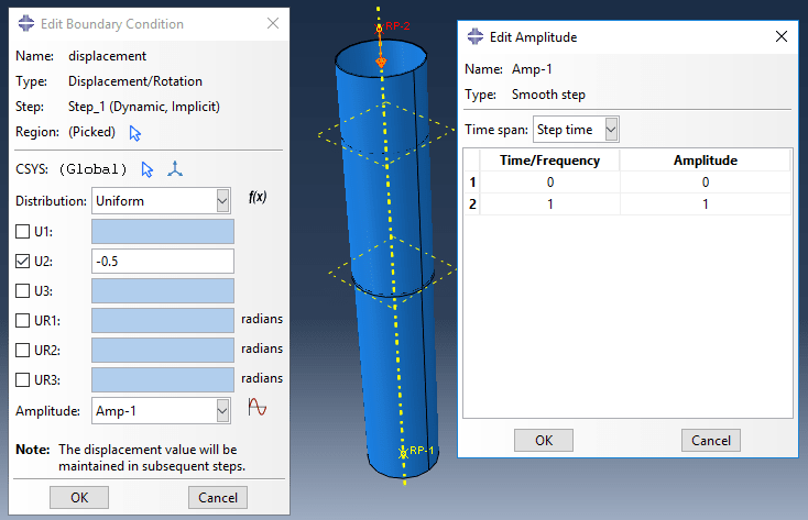

How is the prescribed displacement applied in time (what is specified in Amplitude part of BC definition window in both analyses) ? Do you use quasi-static in implicit dynamics analysis ? Are all units correct ?
I am using SI units (m, N, kg, Pa), and I simply copied the model so the units should be the same. I think it is quasi-static, you can see the BC (-0.5 m in the vertical direction), and amplitude (smooth step). The entire model is around 60 m total in vertical length.

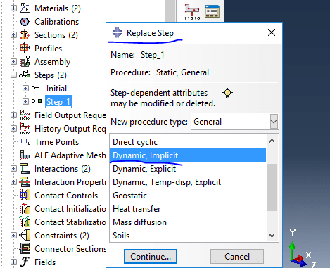

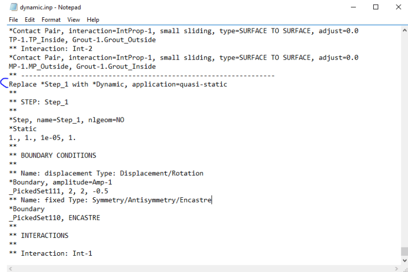

To make sure that both analyses have identical settings try this: copy the input file of static simulation and edit this copy. Replace *Static step with *Dynamic, application=quasi-static. Leave the rest without changes.
Is this where and how I edit? I tried a few edits and could not get it to run.
I also did it within Abaqus as I have not worked much with INP files, is this the same?
Also do you think most likely the static or dynamic step is the correct one if we cannot figure out why there is a difference? Attached is the INP file.
To replace steps in the input file you have to do it manually (delete keyword *Static with its parameters and data lines, place *Dynamic keyword with proper parameters and data lines instead).

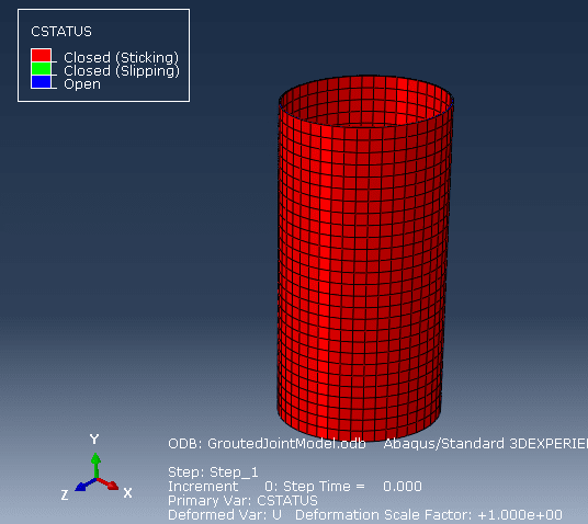

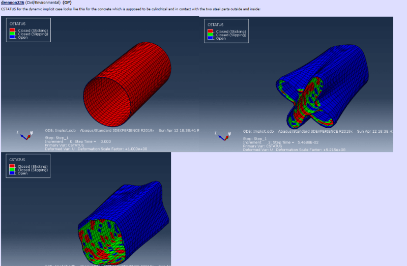

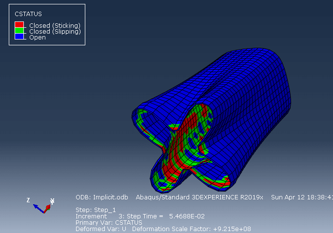

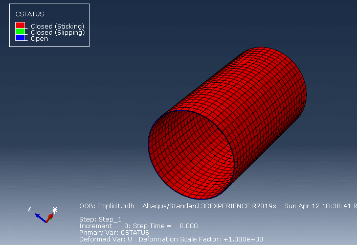

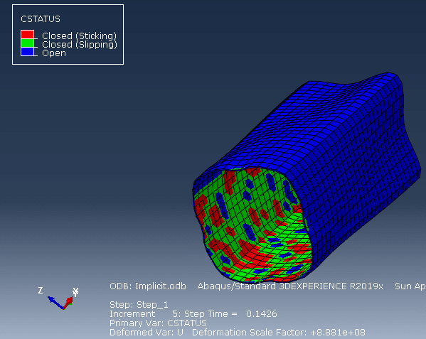

CSTATUS for the dynamic implicit case looks like this for the concrete which is supposed to be cylindrical and in contact with the two steel parts outside and inside:

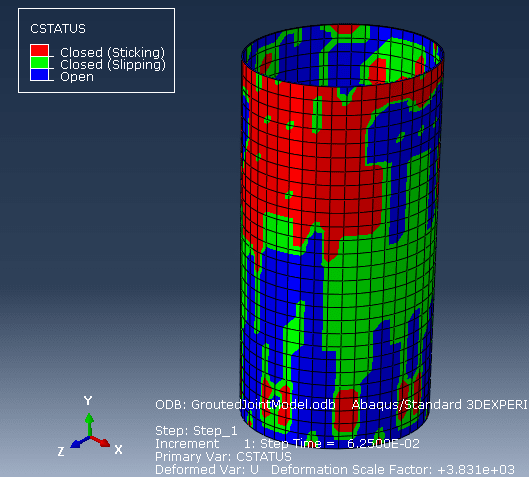

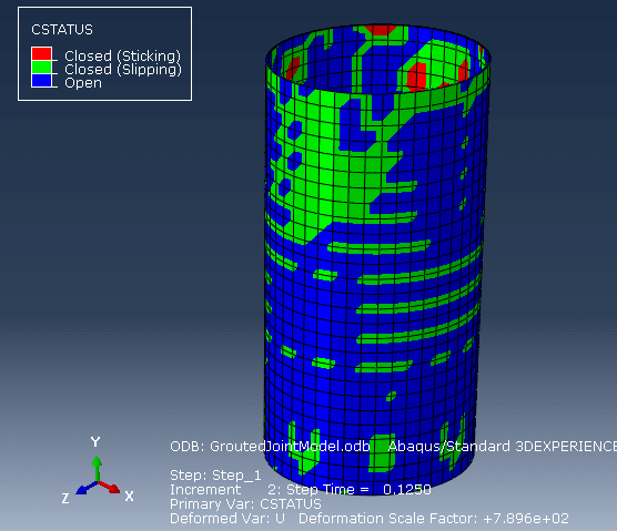

And like this for the static (which looks more correct and not deformed to my untrained eyes):
Deformed shape plots from your dynamic implicit analysis have larger scale factor than those from static analysis, hence the difference in deformations.

Static and dynamic contact defaults are different, which is probably where the issue is I think. And just to be sure, the stress distribution is more regular in the implicit? The left is the implicit case and right is the static.
And for the CSTATUS in the implicit case, is it not strange that the nodes on the outside of the concrete cylinder are open while on the inside they are closed or slipping? Because the concrete cylinder is in contact with steel on the outside and inside.

It seems to be an issue with not fully established contact. Try changing the geometry (diameters) a bit to cause small penetration between the parts and enable the option to remove overclosure.
