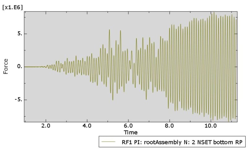

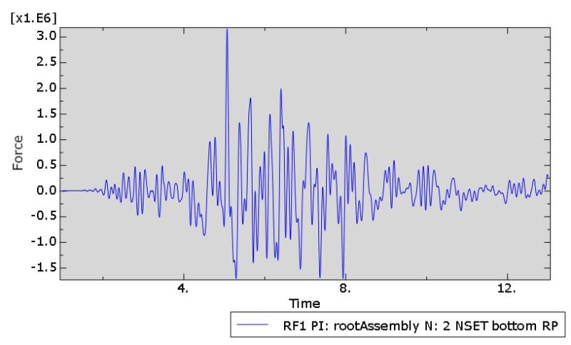

Dear FEA way,
I tried damping with transient fidelity (brown daigram) and as you can see, there are still plenty of high-frequency, resonant noises in the model. The response for quasi-static (blue diagram) looks more sensible but I'm pretty sure it is flawed as well. What do you think is causing the problem? Would you recommend using explicit solvers here?
Moderate dissipation application may be better then, it should reduce noise. Enhanced hourglass control can help too (it can be enabled with *SECTION CONTROLS keyword). If you can't eliminate noise from the analysis you can still reduce it in postprocessing using available filters.
When it comes to the use of Explicit instead of Implicit, I don't think it can help. Noise is usually even worse in Explicit.
