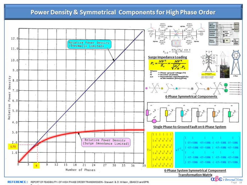

A little bit off topic, but I spoke with a protection engineer some years ago and he was explaining to me a 6 phase system that was operated in New York for a while. I’m working in the area currently but can’t find anyone who knows about this system.
From wiki:
Between 1992 and 1995, New York State Electric & Gas operated a 1.5 mile converted from a double-circuit 3-phase 115KV transmission line to a 93KV 6-phase transmission line. The primary result was that it is economically favorable to operate an existing double-circuit 115KV 3-phase line as a 6-phase line for distances greater than 23–28 miles.
Ok- now I have to know where that was. I thought I know everything about the NY power system- but I guess not.
DTR2011,
I hope I can help with what I can remember from working on this project back in the early 1990s for Ebasco. This project was contracted to us by NYSEG founded by the DOE to be deployed as a demonstration project that was based on the early work developed by in the early 1970s by PTI engineers H. Barnes and Lionel Barthold.
The project consisted of converting a double circuit 3 phase, 115 kV transmission line in a single circuit 6 phases, originally considered 230 kV but reduced to 161 kV because of corona concern. Stil the main benefit of the 6 phase system was to increase the line power transfer capabilities in 173% without the need of changing any insulator or conductor on the existing transmission line.
The six phases of the line were divided into two three-phase groups, one of them with a normal wye/delta transformer with 30o phase-shift and the other connected to the inverted wye/delta transformer with -30o. After superimposed created 6 phase in the line side at Goudey substation and reconverted back to 3-phase at the and Oakdale substation.
The protection system and SCADA at each end of the six-phase line consisted of several separate three-phase multi-functional relays tied together into a six-phase protection system by a common six-phase programmable IED implemented by an excellent P&C engineer H. Panke (deceased). The contiguous phases-to-phase and the phase-to-ground voltages were the same while the line-to-line voltages between opposite phases were double. The symmetrical 6 phase system is modeled with a 6x6 matrix rather than the conventional 3x3 transfer function.
PS: During the 80s and early 90s a lot of engineers from NYSEG, EPRI, IEEE, DOE, and other organizations in the US and abroad were actively involved in writing papers and discovering different options. Unfortunately, I do not see any interest in other utilities to take advantage of and benefit from the experience gained in this project. I hope that in the near future engineers and utilities could renovate interest in this technique to increase power delivery by a T. Line using High Phase Order.

Yes, conversion from 3 phase to 6 phase can increase the line power transfer capability up to 1.73 pu (173%). This is due to the fact the surge impedance loading, SIL (MW), is a direct function of the number of electrical phases.
For other reasons in this project, the transfer capability of the line was limited around 150% of the original line capability.
I hope this answers your question. For additional details, see the excerpt below.
