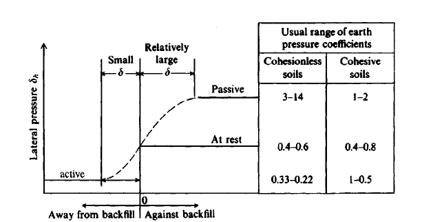

My points based on my past experience,
- The contribution of full passive thrust to overturning resistance is not reasonable . The full passive thrust would develop after almost 50 mm horizontal displacement literally means some permanent deflection at top of post.
- Consider the wt of overburden soil above the spread ftg. to resist overturning .
- If there is pavement around precast sign post, essentially the sliding and overturning will be resisted by the pavement .
- The following picture is useful to see the concept of active, passive and at rest pressure .

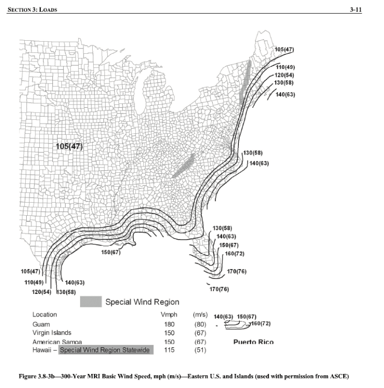

150 mph wind speed seems high for sign that's only 10' tall to the top, unless this sign is going up in south Florida or the Aleutian islands(?).
yeah....AASHTO LTS and ASCE 7 have all of the coastal regions pretty much at that level or higher for the 300yr MRI which is the lowest risk category.

Your profile says you're in California, so I thought you were designing it for there.
