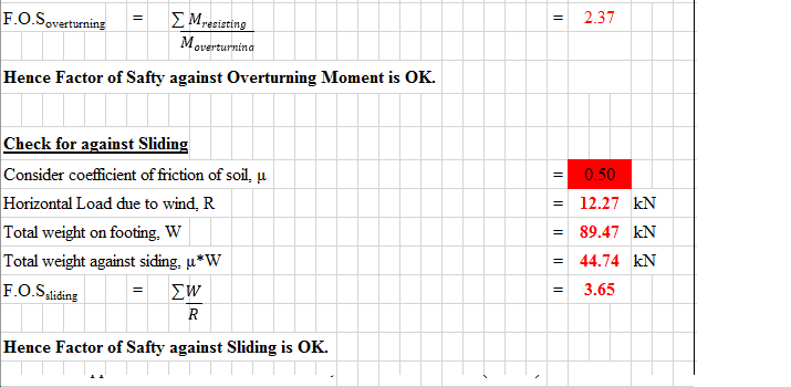

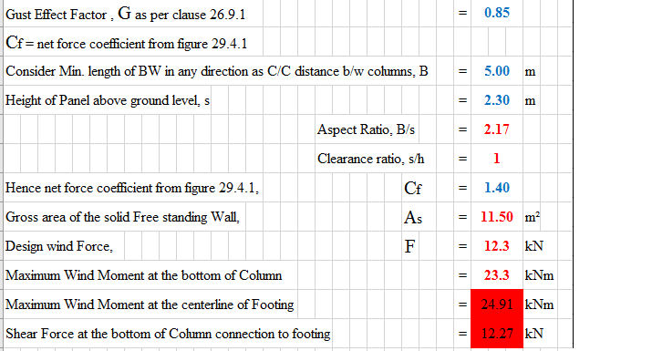

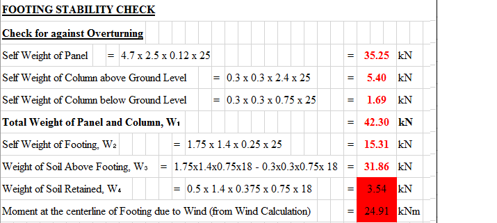

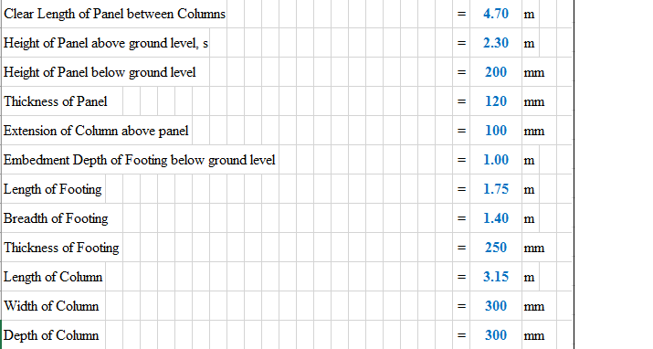

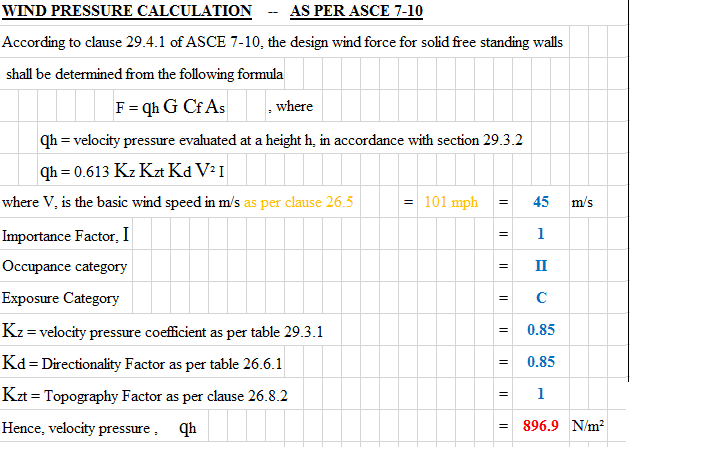

Kindly see attached the excel (calculation for your kind review. I have got confusion in calculating Flexural moment.

2) Below is a suggestive diagram for flexural design (focusing on the slab). As noted before, once you obtained soil pressure, you need to place all loads, that causing the P and M in the analysis, back on the member to perform the flexural calculation, assuming members are cantilevers. The usual governing cases: A) completed structure, and B) construction condition.

1. Fixity shall be assumed at the wall-slab joint, not as shown on face of the toe.
2. Surcharge and LL are not shown, but may need to be considered.
3. Lateral soil pressure on wall is not shown.

Dear retired13,
I have done those cals. Kindly see the sketch below.
The report submitted to us shows 4.62 kN-m. (Loads, moments, combinations, conditions shown are same).
But I get 30.165 kNm (Kindly, refer the above sketch).
I am not sure which is correct. I don’t know how did they arrive that value?
So far, the reported moment is correct. Remember that you need to put all loads back?!
wu2 = 1.2*(0.25*25)*1.4 = 10.5 kN/m (uniform downward pressure due to self weight of concrete slab)
wu3 = 1.2*(0.75*18)*1.4 = 22.68 kN/m (uniform downward pressure due to soil weight above slab)
Loaded span length x = 1.75-0.3 = 1.45 m (distance from heel to face of column)
Mu2+3 = (wu2+wu3)*x2/2 = (10.5+22.68)*1.452/2 = 34.88 kN-m (counter-clockwise)
