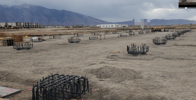

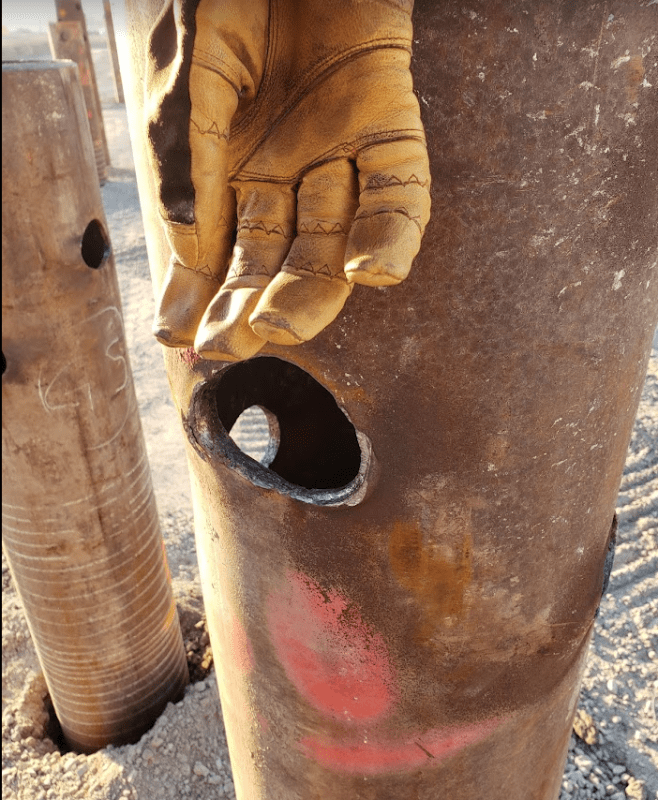

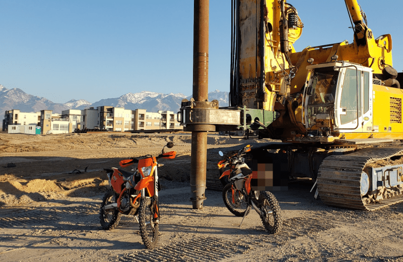

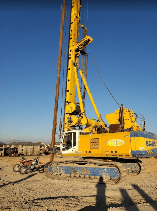

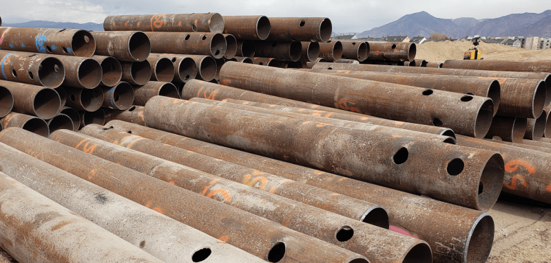

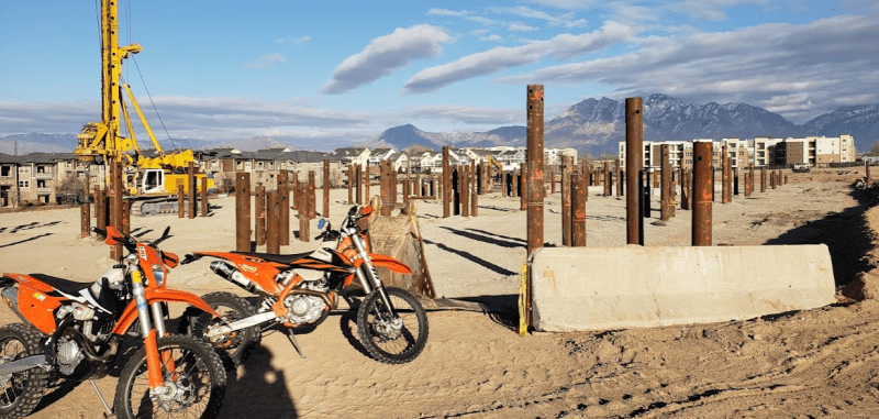

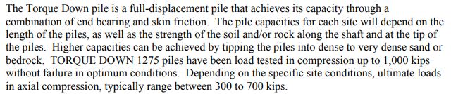

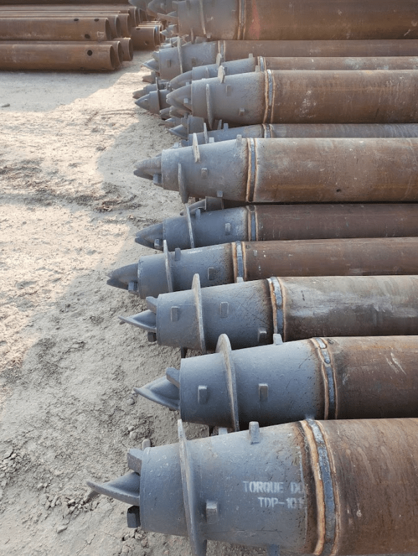

Not really related to OP's question, but I figured yall would like this. We recently did a fairly large building with piles. The site was on a reclaimed superfund site so excavation was to be avoided at all costs. And the costs were high. Supplier was out of California - DrillTech. The product is called TorqueDown, which I believe is just the auger head. IIRC, each cast auger head by itself was around $1k. ~10-12in diam, ~60ft to refusal typically. There were around 800 piles +/- 100. Battered piles were used at SFRS frames and walls. Note the spiral markings on the piles to indicate progress. Also note the ovalization (sp?) of the lug holes in the piles. Lotta torque.
for reference, the bars in those pile caps are #10 and #11.
Are those friction piles, with the auger just to take them down?
That's a drill rig I like. The head seems ideal for difficult drilling, but otherwise, the design seems like a common driven pile.
Funny what you can patent...[ponder]
